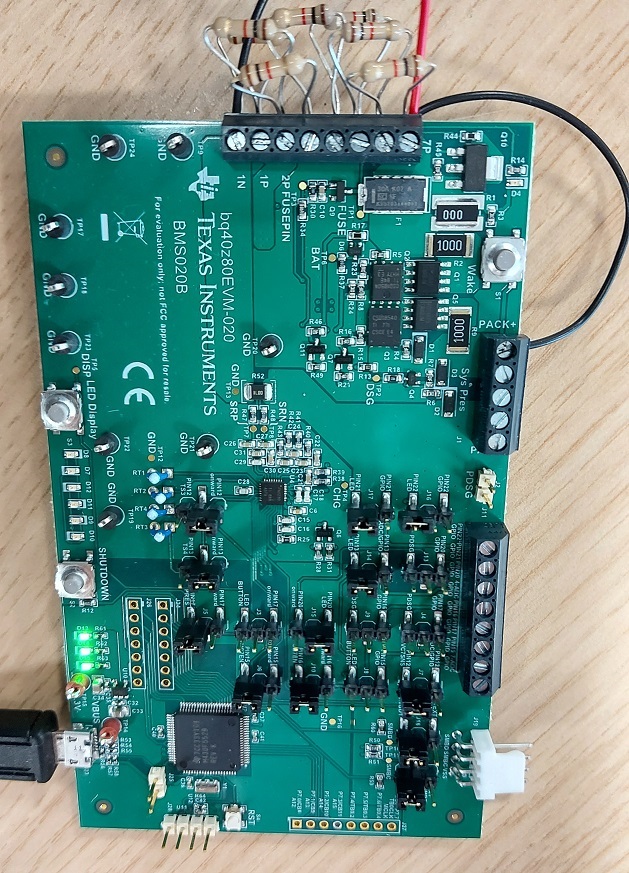

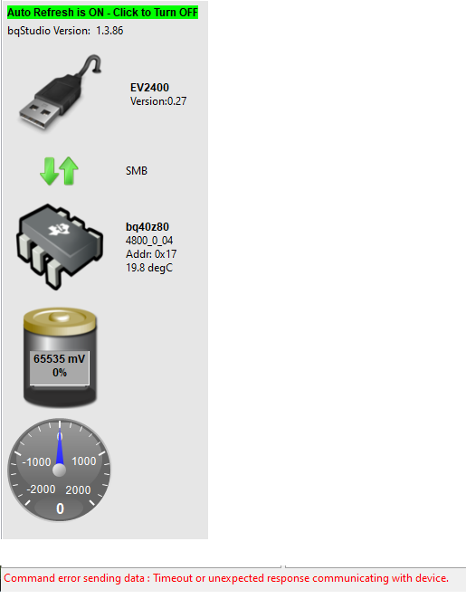

I can't get my BQ40z80EVM to talk to BQ STudio using either my own EV2400 or the on-board one. When I press the wake button, it shorts B+ to P+ but P+ returns to 0 when I let go. Even if I hold the wake button down, I can't talk to it.
I've copied the right bqz file to the config folder. I've powered it with a stack of 7 resistors as the guide says the default is a 7s configuration. The top of the stack is supplied with about 24V.
The EV2400 jumpers are configured correctly as far as I can tell (though the setup guide has lots of missing Jumper IDs!)
Any ideas?
