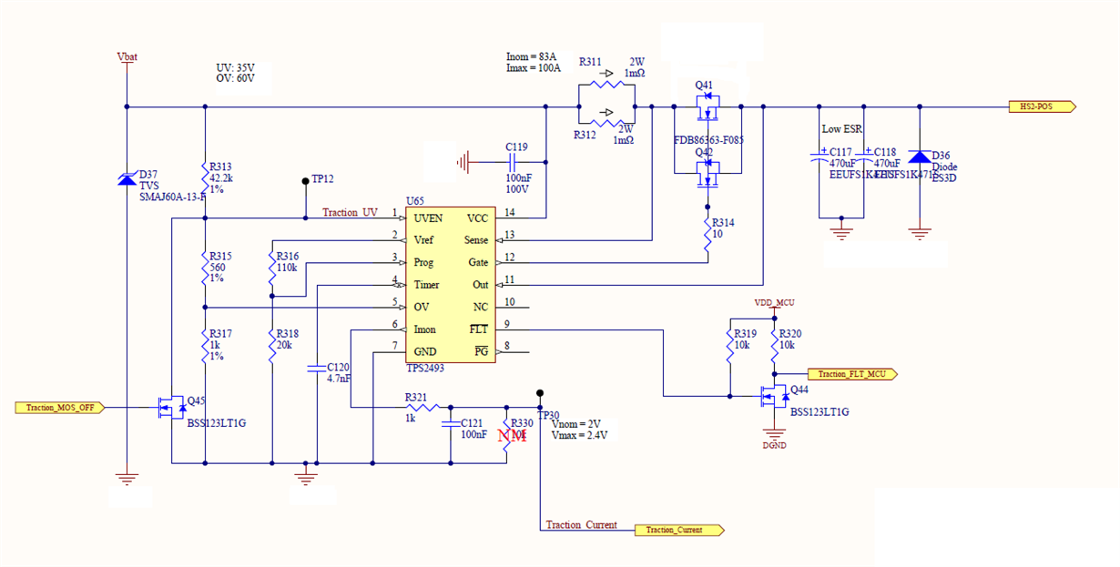

I would use the TPS2493 to protect a motor with 100A current limitation and nominal voltage of 50V. I set the resistors net to obtain the following values:
UV = 35V  (partition on UVEN -pin 1-  is 0.7V)
OV= 60V (partition on OV -pin 5- is 0.46V)
VPROG= 0.615V (on pin 3) to limit the power to about 600W
I used two MOS " FDB86363-F085 "
the sensing resistor is 0.5mOhm
All is connected as in reference schematic in datasheet but I get a behaviour I can't understand:
 - when i use a Resistive load of 160Ohm all works fine and i find exactly the UV and OV thresholds as expected, so the current flows into the load only with 35<Vcc<60 Volts.
 - when i use a Resistive load of 1 Ohm the MOSFET are closed (current flows into the load) even with Vcc=20V. It seems the gate is enabled for some reason that should be inside the TPS2493.
Any support is greatly appreciated.
Thank you very much
