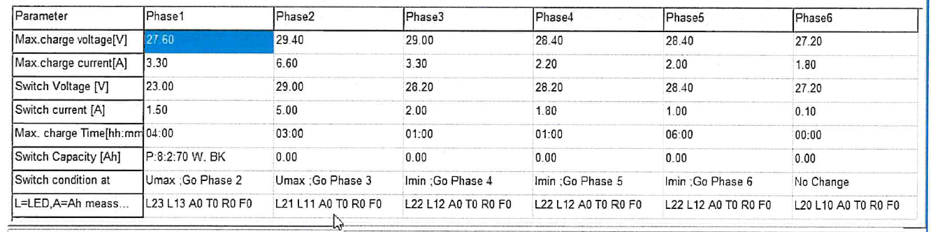

    The capacity is 22000mAh (lead crystal battery, type 6-CNFJ-22, 2 in series, 24V).
    The POR was executed because the SOC was 0% after a "successful" charging indicated by the charger.
    The battery is charged by an independent charger with it own parameter settings and control of the charge cycle.
    Charger and fuel gauge do not communicate with each other during charging. I assume that this circumstance may have adverse effect.
    Additionally, the affected fuel gauge was not sealed and its current measurement was not calibrated (voltage measurement was calibrated).

    I don't know your charger's taper current but one option would be the following setup:
    Charge Term Taper Current (C/10-C/100) = C/40 = 550mA
    Charge Current Threshold (Chg Curr Thrsh < Chrg Term Taper Curr) = C/50 = 440mA
    Quit Current ( < C/20) = C/60 = 360mA
    It depends on what your charger has set for it's taper current because you want the gauge to know it is fully charged before the charger stops charging, otherwise the gauge will not work correctly.

    The taper current of the charger is currently set to 1A. How would you define the thresholds?
    Van
  • Hello Van,
    The gauge charge termination taper current should be higher than the chargers (atleast 10% higher), then just follow the steps outlined.
