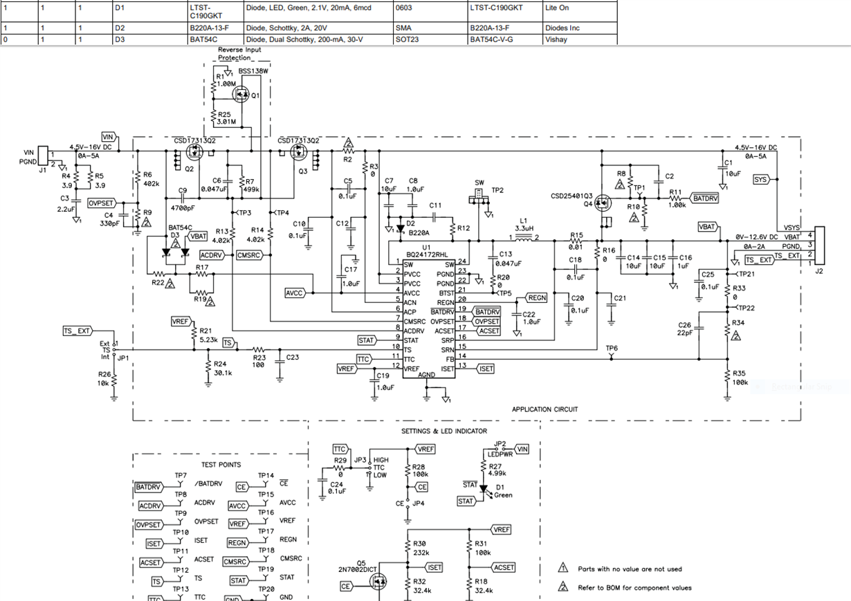

What are the specifications required for this diodes?
Our recommended passive components are reflected in the EVM user guide. Please look at the image I have attached showing our recommended diodes, or refer to the link below:
https://www.ti.com/lit/ug/sluu462a/sluu462a.pdf
