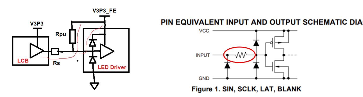

my customer is designing TLC59282 and in their application, they wanted to disable the LED during power up, so they pull the BLANK pin high, before turning on the Vcc.
The series resistor Rs is 33 ohms. In our datasheet, it shows that there is a limiting resistor at the input pin of BLANK. What is the value of this series resistor, and what is the max current capability of the ESD diode? They need this info for the risk assessment of pulling BLANK high before Vcc.
