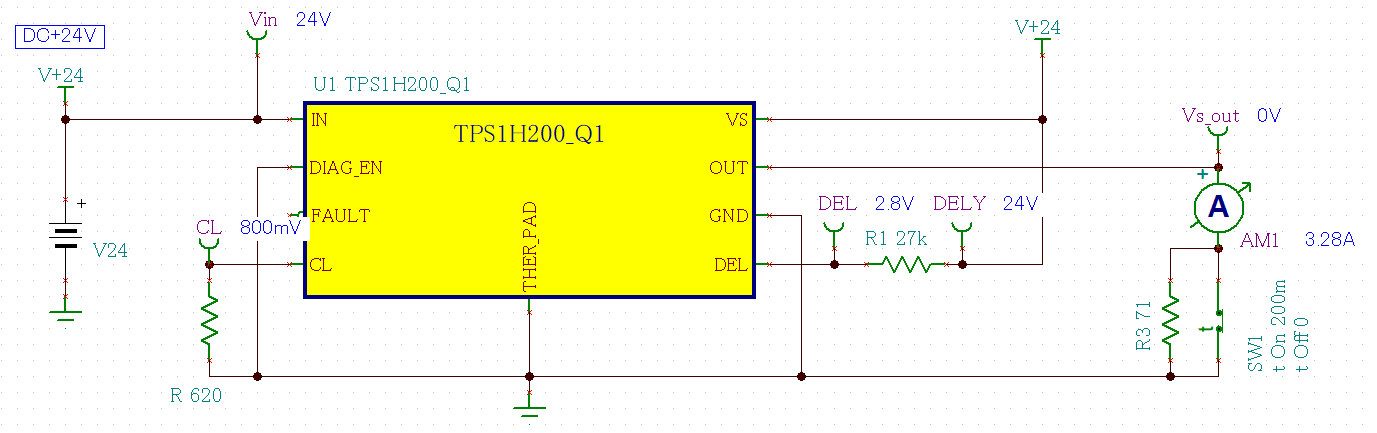

My customer wants to use TPS1H200A-Q1 for auto-retry mode with Vs=24V and DIAG_EN=LOW.
The customer uses model file "TPS1H200_Q1_TRANS.lib" downloaded from TI.com.

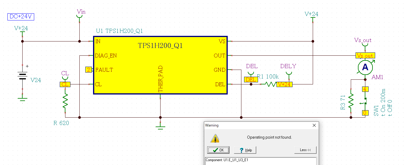

Datasheet says "When in auto-retry mode, the DELAY pin is connected to the VS pin through a 100-kΩ resistor", so the customer drew the circuit as below.
But the message "operation point not found" was showed after executing "calculate nodal voltage"
After changing R1 to around 27-kΩ, the DEL pin showed 2.8V, which i think it means auto-retry function works normally.
Is there anything wrong with the model file or the circuit if "100-kΩ resistor" is correct to use?
