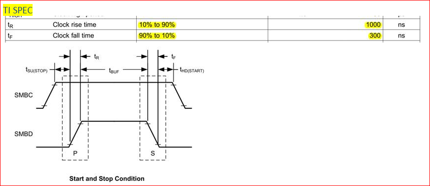

Hi, This Question is base on bq40z50-xx series.

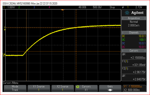

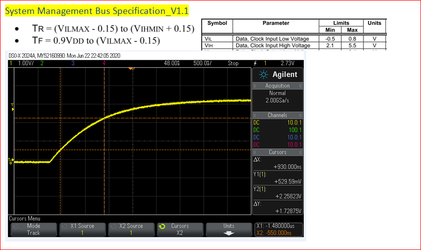

my customer use EV2300 and bqstudio tool to simulate a host communication with gauge, they found the SPEC information about Timing Requirements: SMBus  Clock rise time and Clock fall time calculation is different with SBS 1.1 SPEC, those 2 pictures are same waveform but different with two SPEC effective unit, I tested the EV2300 pull High is around ~3.14V, if use this value to calculate that tR and tF, the TI SPEC value will over that define a lot,
may I studying from you how to calculate this problem and clarify this question, Thanks !
TI SPEC information
