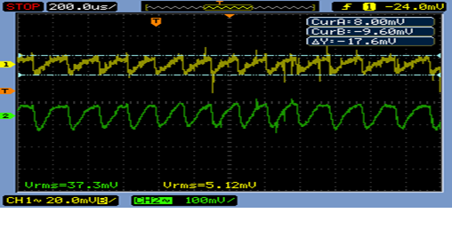

Ripple more than 40mVp-p @ 5Khz with 6mA load @ 3.3V.
as im using for the 4-20mA loop it should be less than 10mVp-p
please suggest some solution.

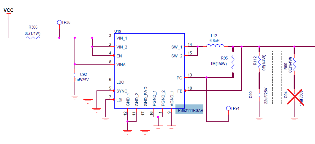

Can I see your ripple waveform and schematic?
Working on light load, less than 10mA. typically 6mA
Input voltage is 6.7V and output is 3.3V
the ripple RMS requirement is less than 2.2mVrms.
Koteswar,
What are each of the channels in your waveform? 2.2 mV is a very low ripple requirement. You will not meet that without a secondary filter or LDO follower. Typically around 7 mV p-p is the best you can do with an ordinary buck converter. What is your timeframe? We do have a new product releasing soon that may work well for you.

The problem is with the Ripple at Vin pin not at the output pin.
How can we reduce the input pin ripple which is causing problems at the 4-20mA loop and ripple frequency(5-10KHz) level is a problem.
Can we increase the Burst frequency above 10KHz without changing load, if so what changes to be made.

I do not see any input capacitors on the VIN pins. You will need 10 uF ceramic at a minimum. If you need very low input ripple more will be required. Possibly an additional LC filter as well.
Yes John the 10uF is there in the other page but placed near to the Vin pin in the layout.

The device i was thinking about has Iq of around 5 mA, so the efficiency will not bee too good. I think in your case an LDO is the best choice.

In PFM mode the TPS62111 operates in a semi-hysteretic manner. It switches at the normal switching frequency until Vout is 0.8% above nominal, then does not switch until Vout falls to the nominal value. This cannot be adjusted.
In PFM mode, the SYNC pin must be pulled low to GND. It has no other function in this mode.
In PFM mode, the ripple voltage will be 0.8% times Vout or about 26.4 mV.
