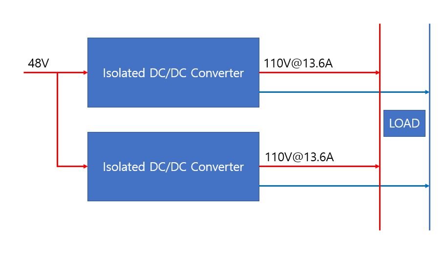

Hello
We are going to configure the system as follows.
I would like to apply load share using UCC29002 to this system.
Could you provide a reference data when the output is 110V for the isolation type?
Best regards.

Hi John
I have checked the data on the webpage, but the reference to the high voltage load share is not confirmed.
What should I do when designing a high voltage load share?
Best regards.
Hi Louis,
Figure 5 of the data sheet shows an application for a high voltage output.
The npn transistor limits the voltage on ADJ to VDD-0.7v
For your 110V application I suggest you use a separate 12V bias supply since it is not really feasible to divide down the 110V with RBIAS1 and RBIAS2 resistors.
You will need a 150V or greater NPN transistor.
John
