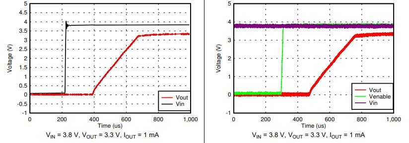

  • Hi John-san,
    Sorry for bothering you again.
    From your formula, if soft start cap slew rate is dominant, the SS time will be 0.55V / (0.03uA/27pF) = 495us.
    However, the SS time on the datasheet scopeshot looks much shorter than the calculation (200-300us).
    Could you please clarify?
    Itoh

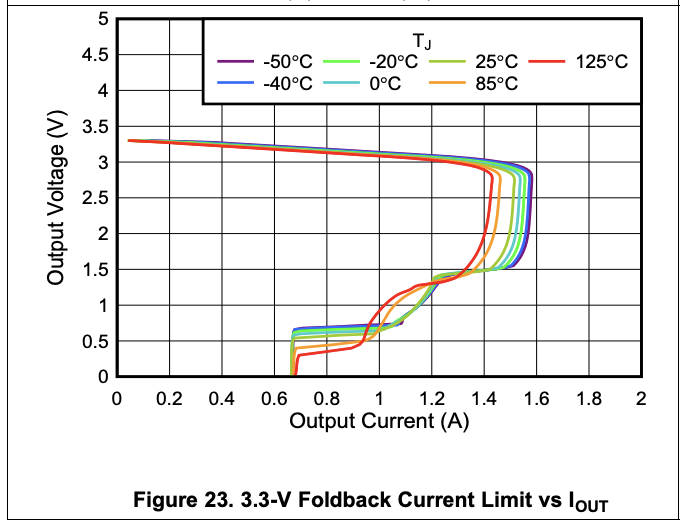

    It does not appear that the internal SS capacitor is dominant here. This means the ramp is limited mostly dominated by both the current limit and the foldback current limit. This makes step 3 a little more complicated as you would need to break up the slew rate into two linear parts:
    1. ILIM_FOLDBACK/COUT during the phase where 0<VOUT<VFOLDDBACK (VFOLDBACK is not provided in the EC Table, but can be estimated as ~1.5V below VOUT as shown below):
    And 2. ILIM_BRICKWALL for VFOLDBACK<VOUT<VOUT_TARGET Where VOUT is the actual VOUT during the soft-start period and VOUT_TARGET is the target output voltage.
    This is difficult to calculate precisely and it might be easier to get an EVM and measure directly with the desired output capacitance.
    I hope this helps to answer your question.

    Let's go back to step1.
    (a) Soft start cap based slew rate is
    0.03uA / 27pF = 1.1kV/s
    (b) Let's say I_foldback = 0.7A.
    In the datasheet scopeshot, COUT is 1uF.
    I_foldback / COUT = 0.7A /1uF = 700 kV/s
    The minimum one is (a).
    Based on (a), SS time should be 0.55V / 1.1kV/s = 500us.
    I don't understand why you think foldback current limit is dominant here.
    I can see 200-300 us SS time from the datasheet scopeshot.
    Could you please double check?
    Itoh
  • Hi Itoh-san,
    These are ideal calculations If you consider the possible tolerances (i.e. actual capacitance and charging current) the ramp could be faster or slower. Keep in mind these are not trimmed parameters. So if I assume that the charging current is 20% larger, and the capacitance is 20% smaller, the time is closer to 300us.
    Does this help to clarify?
