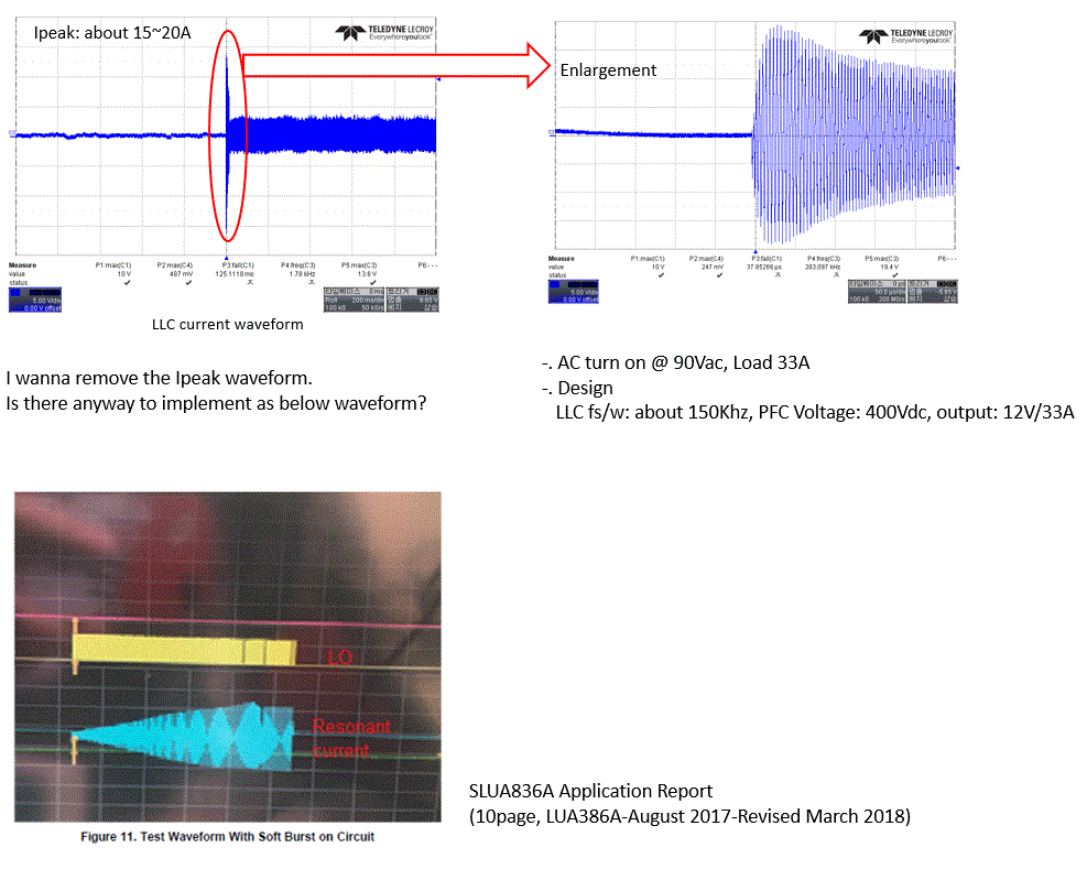

I'm using UCC256303 for LLC control IC.
(Design - LLC fs/w: about 150Khz, PFC Voltage: 400Vdc, output: 12V/33A)
I want to implement the soft start function.
Please see the attached file.(@90Vac, Load: 33A)

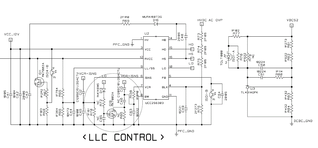

I tried to improve the status to modify the Pin Vcr, Isens and LL/SS.
and added Q19 and other things. You can refer the attached circuit.
please let me know if u can notice some problems and there is any solutions.
Best Regards.
DH.Kim
    The circuit that you added is to improve burst mode and not startup.
    Go to section 5 of the same application note it talks about adding Zener diode and resistor from RVCC and the FB pin to prevent transformer saturation.
    I believe this is what is causing your soft start issue.  You just need to add 6.1V Zener and a 10 k ohm resistor.  The application note shows the placement.
    I would try that to see if it fixes your problem.
