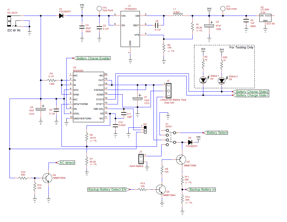

I am using the BQ24005 to charge a 2-cell 18650 2200mAH Lithium-ion battery.
Sometimes, the battery can be charged normally when DC 9V is inputted.
Sometimes when DC 9V is inputted, the battery is charged for 1~2 seconds (STAT1 LED on). Then, the charging stops (STAT1 LED off). The charging will not start again.
But, if the DC 9V is unplugged and plugged again several times, the charging can start normally.
Are there any idea what is the problem going on ?

    APG/Therm invalid and thermal shutdown both lead to STAT1 off -- could be either of these. What is voltage on the APG/Therm pin when this occurs? Does this happen at all battery voltages?
    What is STAT2 doing during this time?
    Please upload the schematic here if possible.

    Please find the schematic of the power part.

    Before, I was using a 9V DC adaptor to charge. But, it seems the voltage drop on the adaptor socket and the PCB traces make the voltage to the charger IC below the operating voltage.
    I am now using a 9.5V DC adaptor to charge. So far, no problem now.
