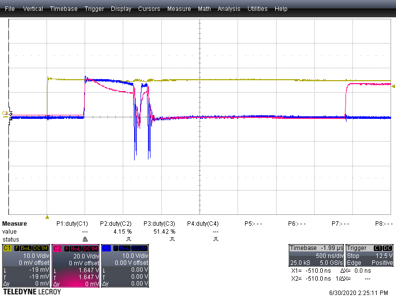

The signals in the following Oscilloscope screenshots are as follows:
yellow: Enable (Pin 4 EN)
blue: Gate Low (Pin 15 LO)
red: Gate High (Pin 19 HO)
Below you see a screen shot of the startup sequence (EN goes from low to high) when the system is working properly afterwards.
Below you see a screen shot of the startup sequence (EN goes from low to high) when the system is generating a short circuit and the system goes into reset. The high side switch and the low side switch are high at the same time point.

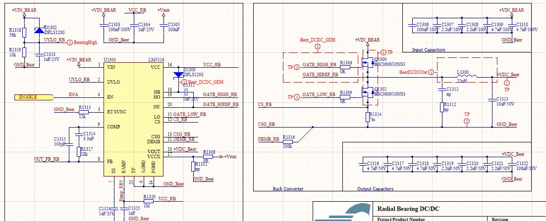

The schematics is as follows:

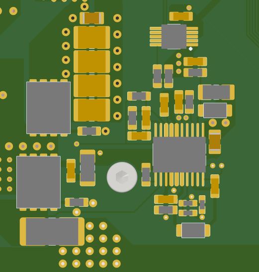

An the layout:
We already exchanged the LM5116 but we still have the same effect. How can this hapen and how can we overcome this short circuit situation?
