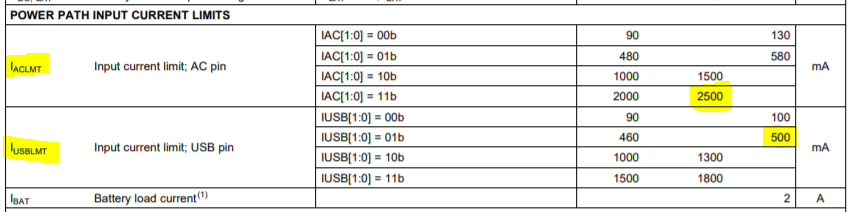

  • Anotoine,
    Antoine Ferran said:
    except for integrated circuit current limiters complying with Clause G.9
    Please refer to IACLIMIT and IUSBLIMIT in the TPS65217 datasheet. IAC[1:0] = 11b by default --> 2500mA current limit. IUSB[1:0] = 01b by default = 500mA
    I cannot say if this is compliant with Clause G.9, but the Power Path Management of the PMIC ensures current limiting on all power supplies.
