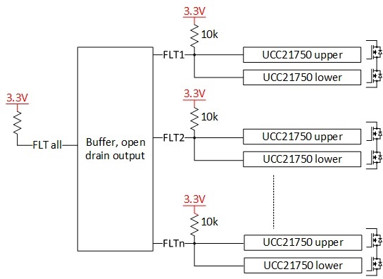

On our in house designed gate drive board, the FLT pin is low but I can't figure out why.
The basic configuration is below. There are multiple UCC21750 chips on the board; pairs of UCC21750s (for driving a half bridge) have their FLT pins tied together and pulled up with a 10k resistor. These FLT1-FLTn signals are then fed to a buffer where the FLT signals are ANDed into one single FLT_all signal.

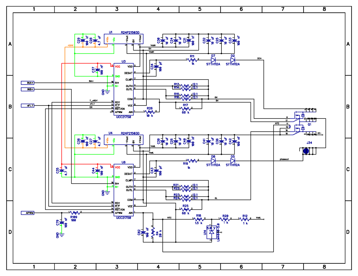

    FLT should only be pulling low if there is DESAT on your switch, after the deglitch filter, and when PWM input is HIGH, so its strange that it should be triggering when the devices aren't operating. We might also look at a cause on primary side as well.
    Would you be able to share your schematic for your design?
    And , could you try toggling RST according to D/S in order to clear the FLT condition, and let us know about the behavior after that point?

    Here is the schematic for the gate drive portion.

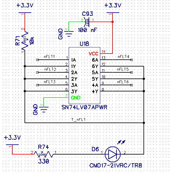

    Buffer part is here. Not pictured is the 10k pull up resistor for each FLT1-FLT6 line. Also, I failed to mention last time, the FLT1-FLT6 signals are also connected to GPIO on a uC. The GPIOs on the uC are set to "no pull".

    Another strange thing is, when I lift pin 1 on the buffer IC to remove the buffer 1A from the circuit, the FLT1 behaves as expected - it remains high at all times. So it seems the buffer has some effect, but it doesn't make any sense.

    based on your description It is almost sounds like the buffer itself is shorting inputs to ground, which itself seems very unlikely. i couldn't see any issues with your schematic either.
    Lifting the buffer on outputs can't cause the device itself to unlatch a clear fault, so its safe to say it is relating to the buffer or something else on primary side that causes the outputs to pull low, but the gate driver IC should still have no actual fault latched.
    The only other mechanism  i could think of is if, when connecting the buffer, buffer it is shorted internally so consumes so much current it causes the 3.3V rail to drop out, but this would be easy to check and seems increibly unlikely, and it still wouldn't explain why lifting one input pin caused the FLT to go back high
    If possible, lets try by removing power to the buffer by cutting VCC or GND, then (or lifting input pins ) on your hex buffer and see if that caused the rest of FLT pins to function OK, then we could isolate the point of the issue.

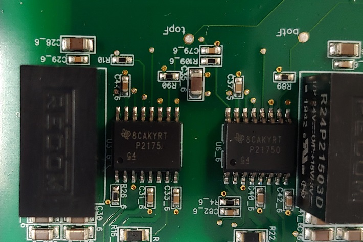

    I went ahead and desoldered the entire buffer chip and lifted the GPIO pins from the uC (microcontroller) that are inputs for the FLT1-FLT6 signals. So now the FLT signal is only influenced by the UCC21750.
    No matter what I try, the FLT signal still goes low when the uC commands the EN to high. I tried giving PWM inputs to the IN+ pin and it doesn't make any difference.
    Here is a picture of the chip on the PCB. Can you tell from the markings if this is the correct part?
    This is the right IC.
    FLT can only go LOW when PWM input is HIGH, and can be reset if nRST goes low longer than the glitch filter time. If FLT goes low even when PWM inputs start out low and stay low, there is either a problem with the board, and potentially but very unlikely, the drivers. potential problem with the board could be fabrication tolerace which leads to some insuficcient clearance in a via with ground plane for example, then its shorted internally. I've had that happen personally.
    Again, your schematic looks fine. Nothing there should be causing an issue. Now we've eliminated one possibility

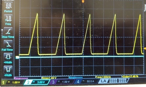

  • By disconnecting the FLT lines from the uC and buffer, I tracked the issue down to the root. Without a MOSFET connected, the desat pin voltage charges up. If the PWM duty cycle is long enough the voltage will go past the threshold, yellow trace is the desat pin voltage.
    Initially when I measured 200mV on the desat pins, it was most likely that the UCC21750 had already tripped and disabled the outputs, but there was likely a big initial spike on the desat pin to trip it. When I connect a MOSFET, things behave as expected.
  • I had thought you had connected the MOSFET, now your issue makes total sense. Ok, its good to finally solve the issue.
