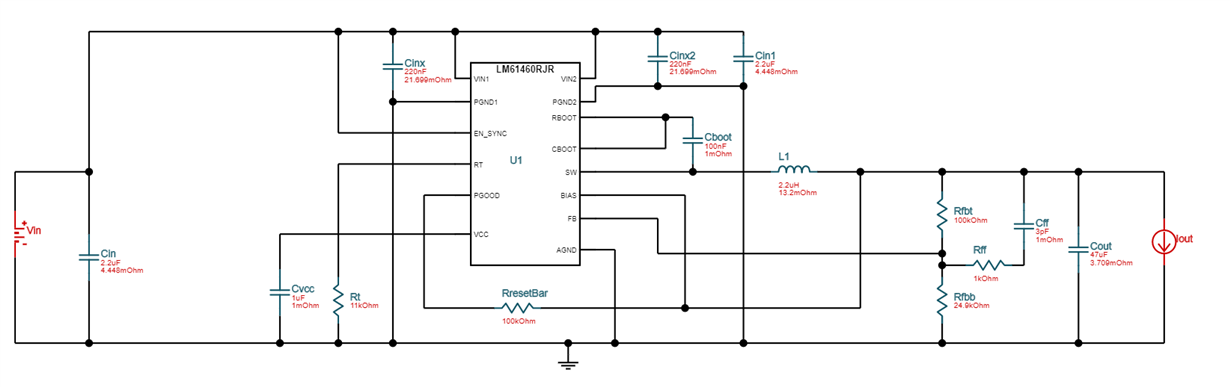

Hi, I am trying to use LM61460 for the system.
Vin : 24V
Vout : 5V
freq : 1.18Mhz
Iout(max) : 5A

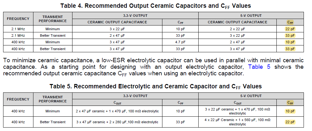

In the datasheet, recommended Cff for the Vout 5V is about 10pf~30pF.
But from the webench desing tool
Cff value is 3pF.
I am confused. Which value is more adequate for my system?
Vin : 24V
Vout : 5V
freq : 1.18Mhz
Iout(max) : 5A
  • Seokmin,
    The tables you show are for 2.2MHz and 440kHz designs.
    Table 3 in the datasheet shows a 1MHz design with a 4.7pF CFF.
    3.3pF and 4.7pF should be close enough to have similar results.
    Otherwise, if you use a larger COUT than WEBENCH recommends you will see better transient with larger CFF.
    Hope this helps,
