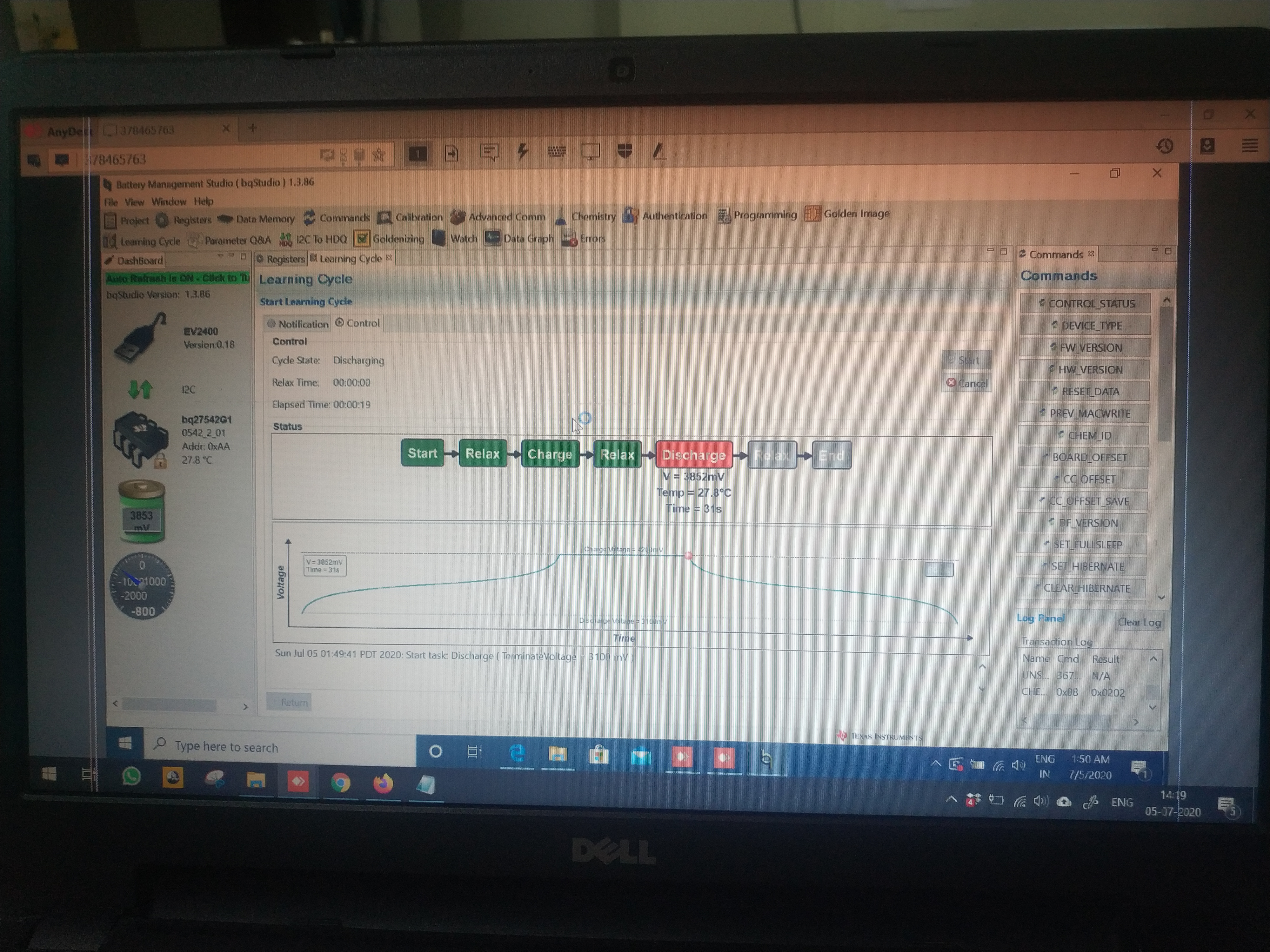

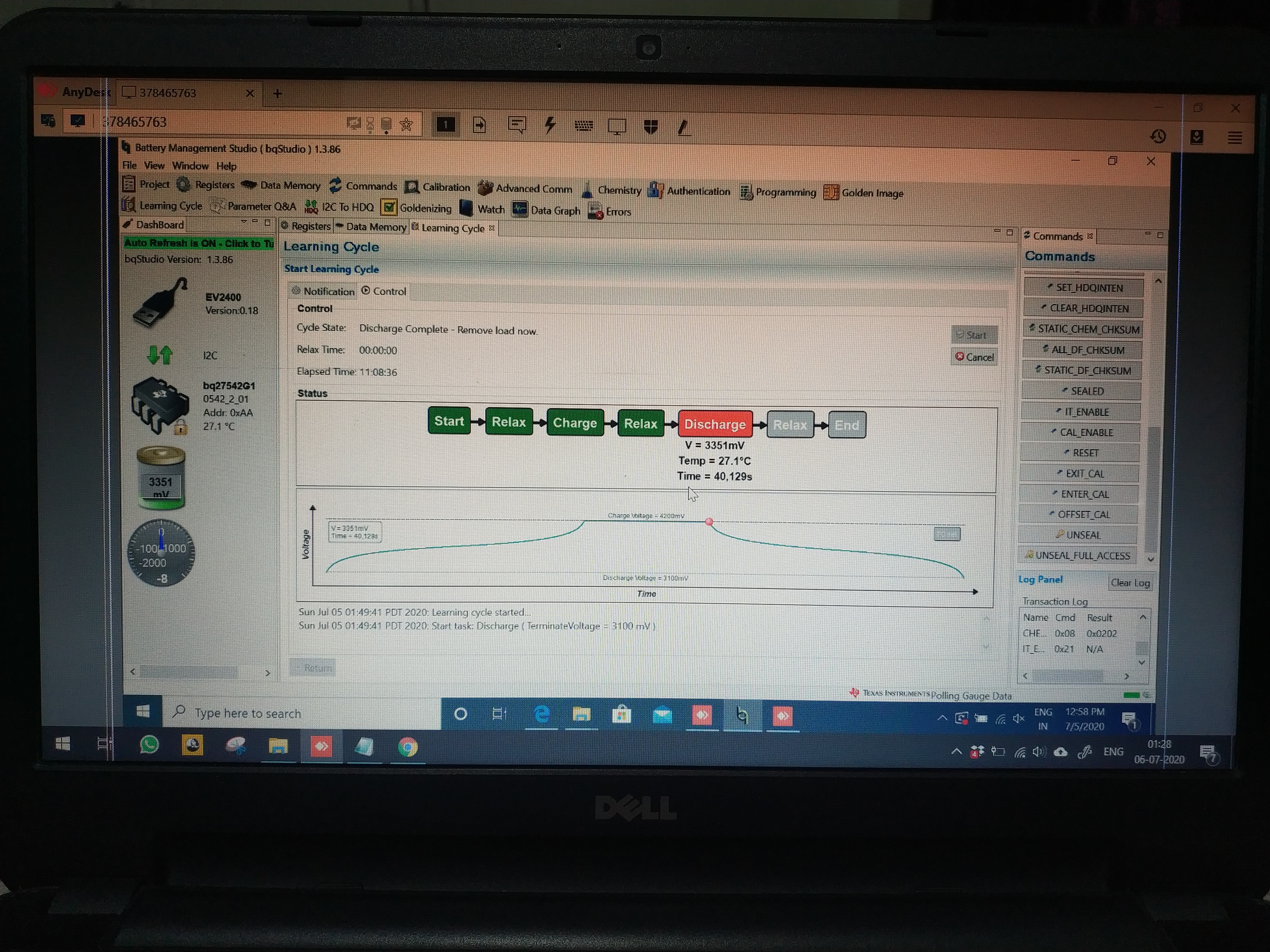

    suggested chemistry ID not available in BQstudio default list that's why we try to execute learning cycle with 0202 chemistry ID but we facing same issues, why the cycle not going into the relaxing state and forward ..? after the discharging is hold the Discharge completed-remove load now state please take look of pic and DF file DF_Parameter_30062020.gg.csv
    I need fix it ASAP, what i need to do ..? where we are doing wrong ..?please help figure out this problem and to generate a golden image file

  • The best chemistry id 225 seems okay to me since the max DOD deviation is 4.39.
    I have reviewed the ivt file again. Still, I can a small current during the relaxation period. However, I guess you can use the chemistry id 225 for your learning cycle.
    In addition, I can confirm that I see the chemistry 225 in the bqStudio. Please download the latest Chemistry updater here and update the chemistry library.
    Besides, I would suggest you follow the app note below to do the learning cycle manually since it is much easier to find what's wrong if you see a problem during the leaning cycle.
    http://www.ti.com/lit/an/slua903/slua903.pdf. Also, take a look at Appendix C of the BQ27542 TRM.
    You will find the most common problems seen during the learning cycle and how to deal with them.
