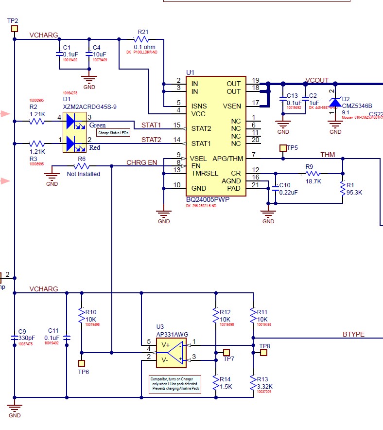

BQ24005: Using a comparator to turn on charger is hit or miss
Part Number: BQ24005
I am using a comparator to sense the presence of a pull down resistor (499ohms) in the battery pack. The EN pin on the BQ24005 is held low by the comparator until the pack is plugged in. Every time I plug in the pack (which also has NTC thermistor set for 10K at room temp) the charger will flash the STAT1 LED for just an instant. Other times it will charge but the charge current is only 75mA with a 0.1ohm sense R.
VCHARG is 9V in this case. BTYPE is the connection to the 499ohm pull down resistor in the pack.
