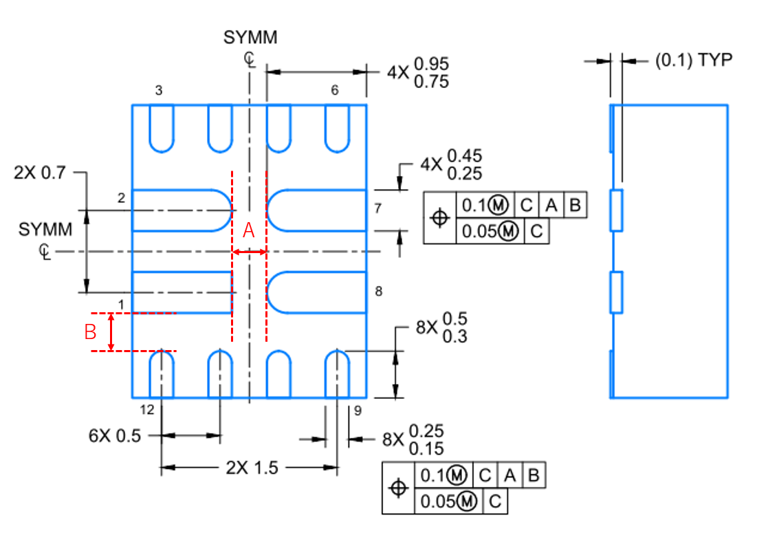

Could you please tell me the minimum distance regarding the following A and B when considering the tolerance of outline dimensions?
Kato
Kato
Hi Kato,
I apologize for the late reply. I just want to provide an update that I'm currently working on getting these dimensions for you and will get back to you as soon as I get the information from the packaging team.
Andy Robles
Hi Kato,
Find below the expected minimum distances:
A = 0.3mm
B = 0.325mm
Andy Robles
