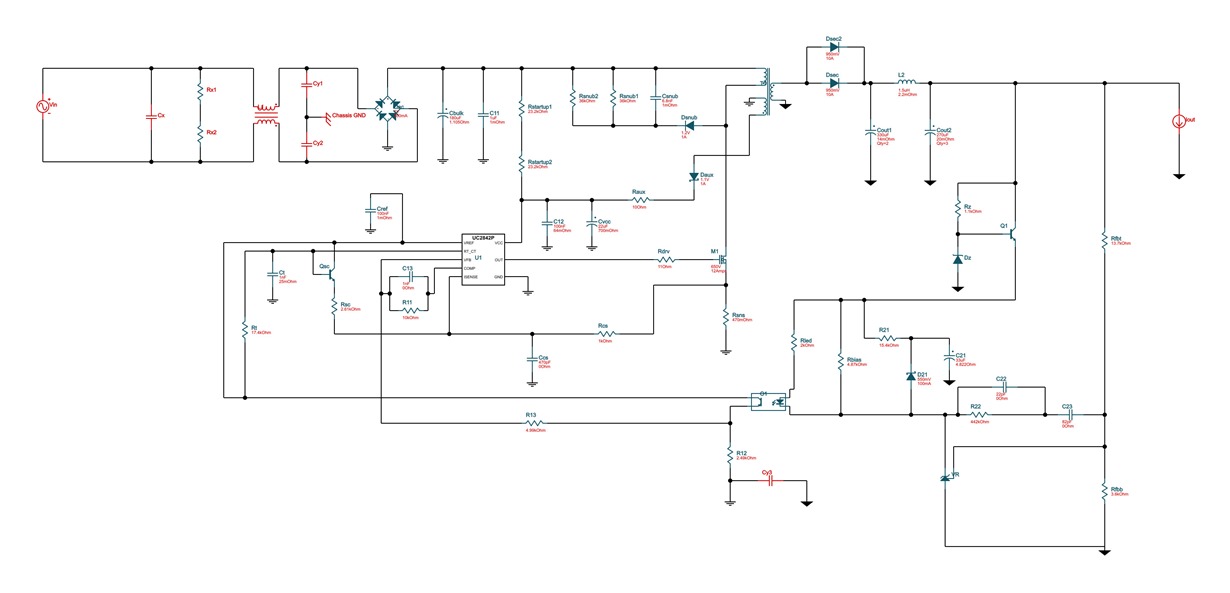

I have done a power supply design in WEBENCH and and i have to design a battery charger with the same specification please provide your suggestion on the changes i have to make.

  • Thanks for your reply. Sorry for my late reply as i have changed the design using the IC UCC 28700 and have some doubt about it too. Can it use to charge a 12v battery and if the battery draws more current than the specified then the output limit it or not. WBDesign44.pdf

    The UCC28700 will provide a primary side current limit set by the current sensing resistor Rcs. The primary side current limit is modified by the 7.5k resistor at CS so that if the input voltage increases or decreases the CS limit point (on the primary) is decreased or increased so that the output current limit point remains constant.

    Thanks for your answer. I have one more concern about the battery voltage too. If battery voltage is too low then what effect it causes on output current. Is that just limit the current or there is any mechanism that turnoff output when vout is low or current drawn is high.

    If the battery voltage is too low then the controller will limit the output current at the current limit point. There is no auto disconnect or auto off feature on the controller so this type of protection will require additional circuits on the secondary side.
    BTW: if the battery voltage is 'too low' then depending on the type of battery and its chemistry, it may be damaged if the initial charging is done at the normal charging rate.
