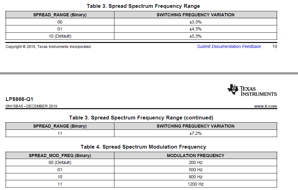

Q. I would like to know the guideline how to decide the register of SPREAD_RANGE and SPREAD_MOD_FREQ. Can you let me know the meaning of them?
In my understanding, SPREAD_RANGE equals "2Δfc", SPREAD_MOD_FREQ equals "fm" as written in below application note. Is it correct?
https://www.ti.com/lit/an/snva974/snva974.pdf?ts=1593769361622&ref_url=https%253A%252F%252Fwww.google.co.jp%252F
Q. Can you let me know the pros/cons of higher/lower SPREAD_MOD_FREQ.
    No. Please refer to the following table.
    Yes.
    I think this question is already described in the link you provided.
