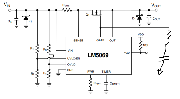

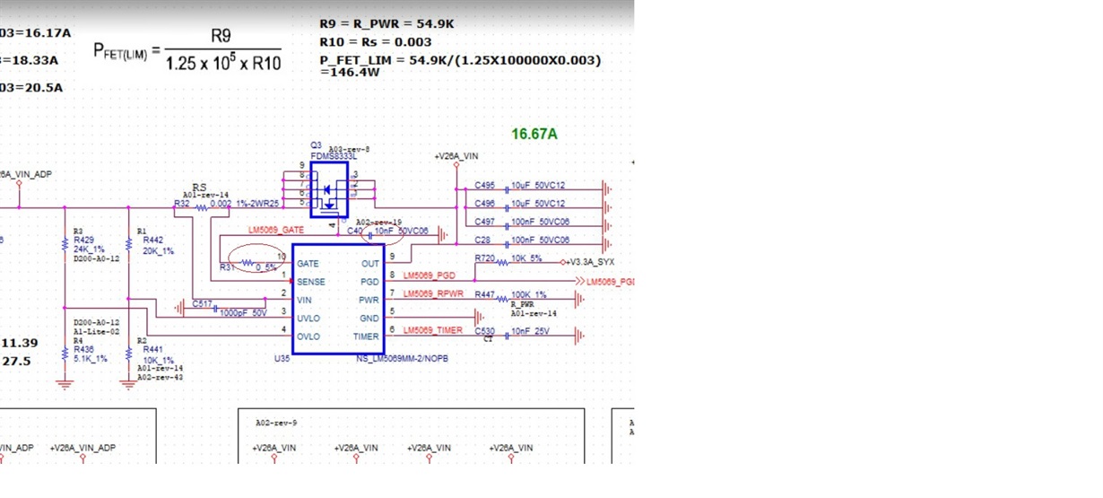

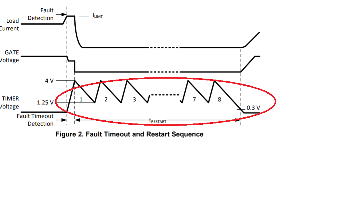

Hi
When OVP and UVLO , Will TIMER have a red waveform?
