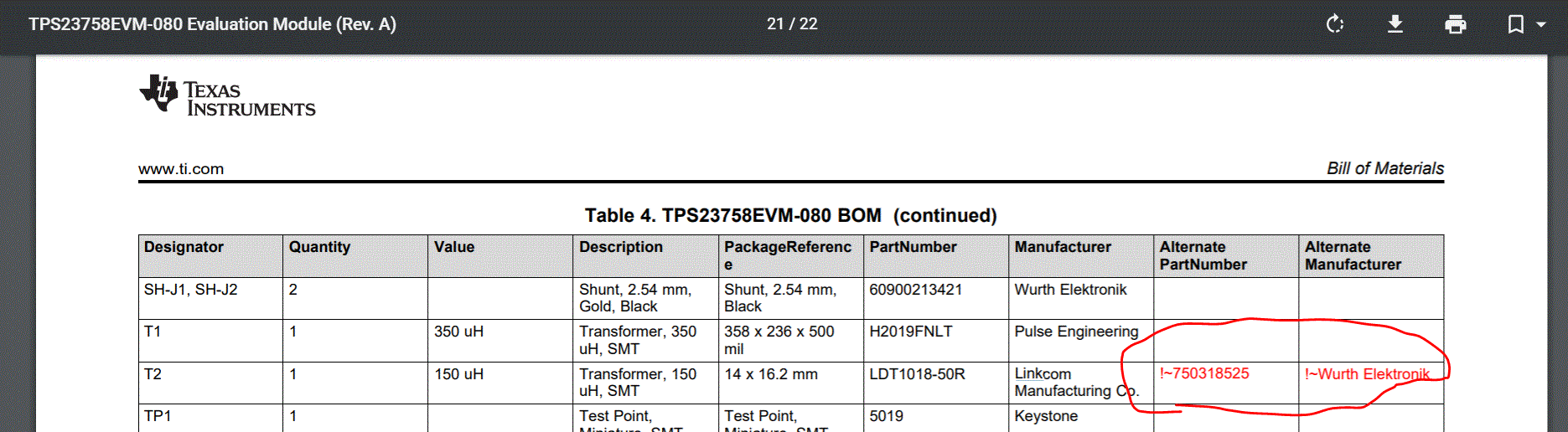

Hi Support Team,
I am designing PoE solution based on the TPS23758, and similar to a previous post here,
can you please share alternate P/N for LDT1018-50R transformer?
AJ
Hi AJ,
Thank you for your question.
The alternate p/n for the LDT1018-50R is the 750318525 by Wurth Electronik.
This can also be found on the TPS23758EVM BOM as an alternative xmfr p/n.
Please let me know if you have any additional questions. Thanks!
