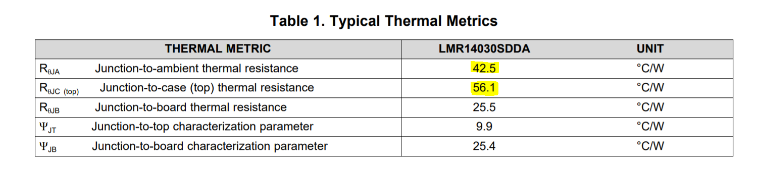

Dear TI Team,
In datasheet I have found Rjc is higher than Rja. But what I understood is Rja=Rjc+Rca. In this sense Rja should be higher than Rjc right?? Please help me to solve my doubt..
How to calculate Tc(case temperature),
Below is correct ??
1) Tc = Rjc x Pd
or
2) Tc = Tj - (Rjc * Pd)  , If this 2nd case is correct means, I get negative temperature for example ( ie,
At 0Deg.C ambient,
Tc= 0 + (Rja * Pd) - (Rjc * Pd)
Tc= (Rja -Rc) * Pd
Tc = (42.5- 56.1) *Pd
Tc= -13.6 Pd
Please advice.. How to calculate.
