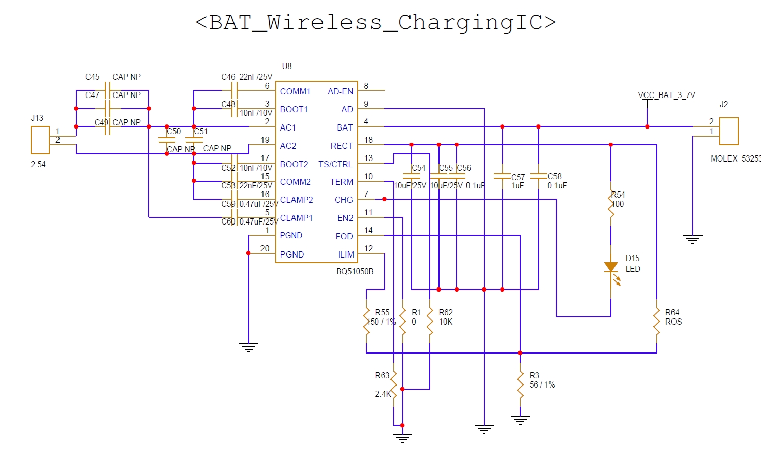

    I am SeokHo Yu who is working at Hyundai Automotive Group.
    I am developing a device which is supporting wireless charging system.
    The device will contain 3000mAh Li-Ion Battery and It can charge Battery up to 1.5A .
    What i know is BQ51050B can charge Battery up to 1.5A . So I select this component and design circuit.
    - First, I want to Know whether there are some errors or not. Please refer to Attachment.
    - Seccond, I put the LED at RECT Pin and connect CHG pin. While doing Charge LED ON and finish Charge the battery i wanna let LED off. (The referece design LED is connected between BAT and CHG pin)
    - Thrid, How can I decide the value of Ros (R64)? I've searched technical document but i couldn't find it. Please guide for me.
