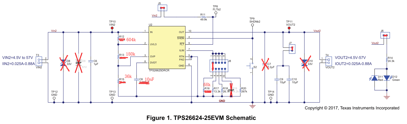

I am testing the TPS26625 using development board TPS26624-25EVM, designed as below:
Target input voltage range: 4.5-27V;  Input current limit: 98mA.
Here are the problems we met:

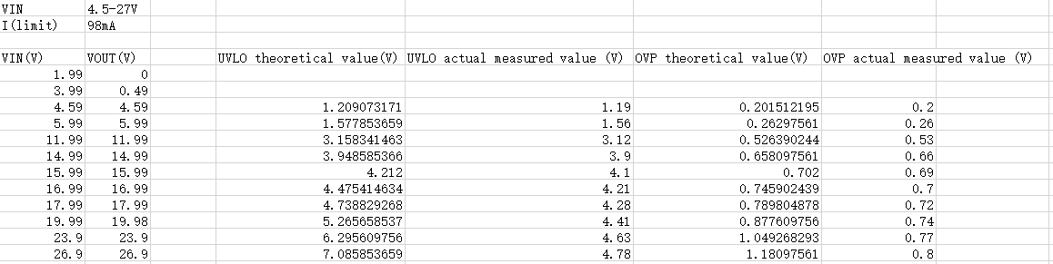

When the power supply is below 15V, the actual measured voltage value of UVLO pin and OVP pin is basically consistent with the theoretical value;
However, when the power supply is above 15V, the actual measured voltage value of UVLO pin and OVP pin differs greatly from the theoretical value.
What could be the cause of this?How should we solve it?
