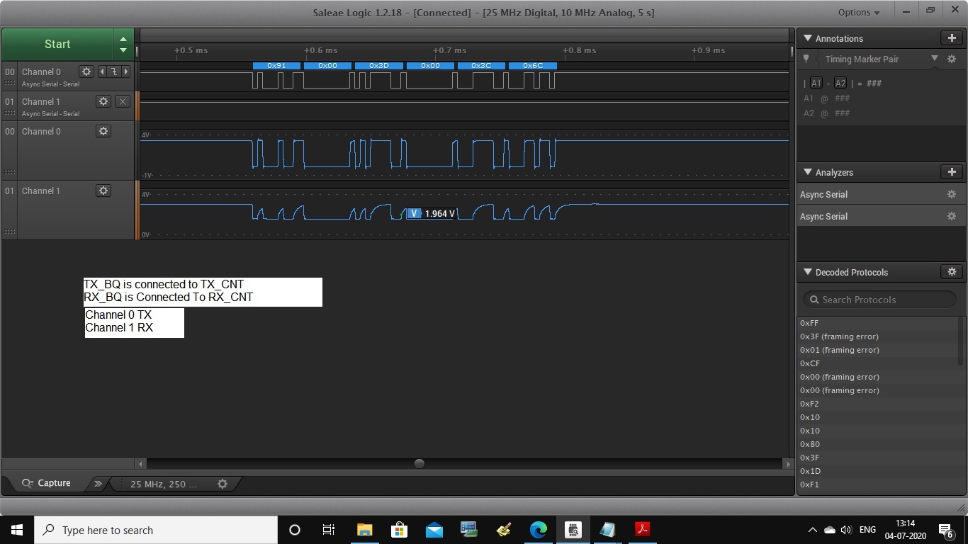

I have been trying to connect the BQ76PL455A-Q1 (BQ ic for short) to my MCU on a custom board. I am only using a single BQ ic chip right now and have no plans to do any daisy-chaining to this chip. I have added the required pull-ups resistors and other resistors and capacitors as mentioned in the design reference document.
Here are the voltages I observed in Idle state:
  • V5VAO = 5.1V
  • VP/VDIG = 5.3V
  • VIO = 3.3V
  • RX = 3.3V in idle state
  • TX = 3.3V in idle state
After checking voltages, I was looking to set up communication and I sent out the following commands:

For now, I simply hardcoded the CRC after calculating it on an online calculator. The commands above are modified from the software design reference document available for BQ76PL455A-Q1.
While sending out the commands, I connected a logic analyzer on the RX and TX pins of the BQ ic. In my design, I was not sure whether it is a direct connection (TX to TX, RX to RX) or cross-connection (TX to RX, RX to TX), so I have added some jumpers which will allow me to switch between both the configurations. I have added some screenshots from the logic analyzer. I am observing some data ripples on the RX line while transmitting from MCU. Also, there is no response from the BQ ic after I send out the 11th command from the above snippet of code.

    I have added 100k pull-ups from RX and TX to VIO, added the 50ohm resistor in series with the UART. The Wakeup I am independently triggering from another source (all GNDs are common).
    In the images attached to the original post, what could be the cause of the Transmitted data being reflected onto the RX line?

    It is hard to say why 3.3V would not work based on your comments vs 5V unless something is not configured correctly, but ensure you follow base device VIO connection to host side driver for logic reference rather than VP as for stack device. I see a few next step options:
    1) Scope probe 3.3V logic for RX/TX/VIO/GND to see if its really high enough to meet Vio thresholds of device.
    2) Install level shifter or digital isolator between host mcu and BQ to shift 3.3V logic to 5V. This is how we drive our next gen devices with 3.3V logic that do not come with VIO pin for this purpose and the device requires 5V logic.
