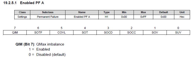

1.TRM page.182, 19.2.5.1 Enabled PF A
    QIM (Bit 7): QMax imbalance
    1 = Enabled
    0 = Disabled (default)
   "1" means permanent fault check ? or "0" means permanent fault check

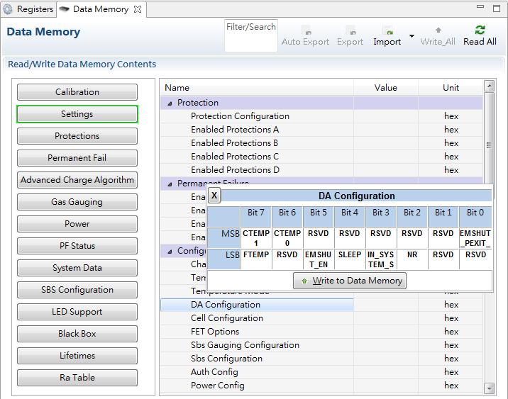

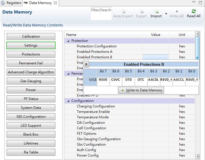

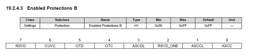

2.Settings->Protection->Enabled Protections B
Bit0 inside, different from TRM (see screenshot)

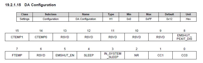

3.Settings->Configuration->DA Configuration
Bit1/Bit0 inside, different from TRM (see screenshot)
