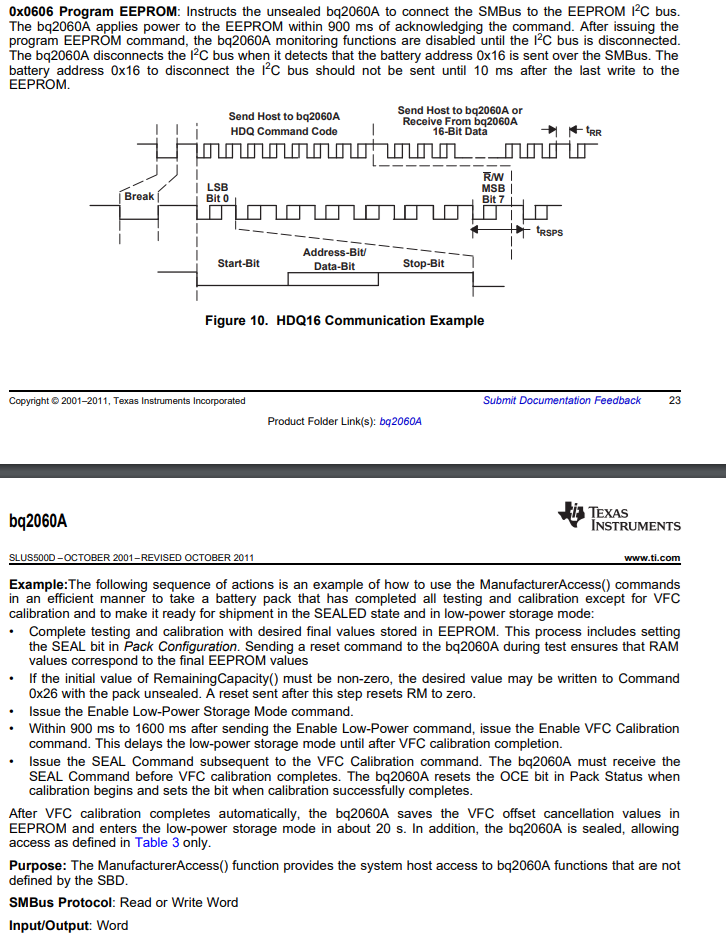

Customer is creating a custom production test interface for BQ2060A.
When reading 0x2F they see 0x2080.  So it appears the bit has been unsent.
When sending the 0x0606 command would they expect to see the eeprom on the i2c bus?
Please advise.
