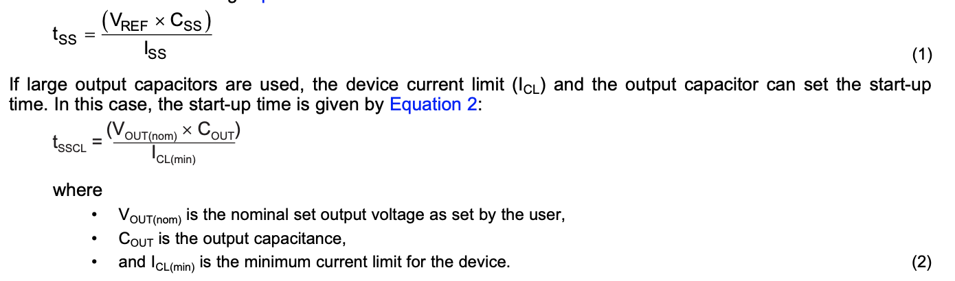

Also, please clarify if the output capacitors affects the soft start time

    This will work. If you are not using the PG pin it can be either grounded or left floating as it is open-drain. You may want to add a feed-forward capacitor from VOUT to FB as an option. This can help to further reduce PSRR and noise.
    With respect to soft-start time, both the SS (Soft-Start Capacitor) and COUT will impact the ramp time. This is shown here:
    Does this help to answer your question?
    Thanks for your quick response.
    We have 58uF load capacitor on the LDO output. (Tsscl ~ 1ms). But we have configured the tss using Css capacitor as 2.41ms.
     Which one will actually come into picture? Either 1ms or 2.41ms?
    Preethi
  • Hi Preethi,
    The CSS capacitor will dominate the soft-start time.
