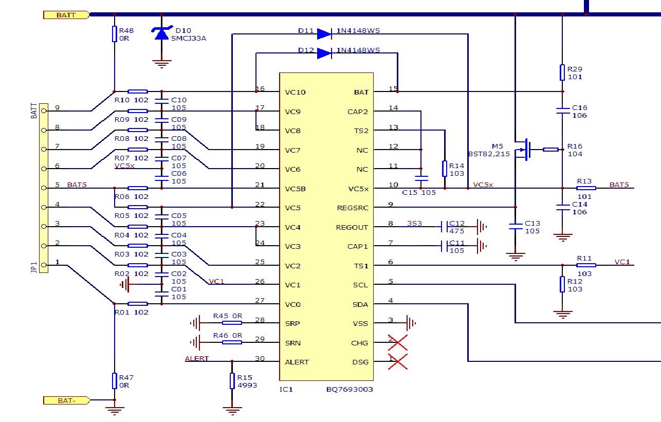

BQ76930 with 8-LiFeO4, Data Acquisition and Communication Only.
1. No.4 CELL about 0.6V
2. R06 Voltage=2.4V
2. R06 Voltage=2.4V
