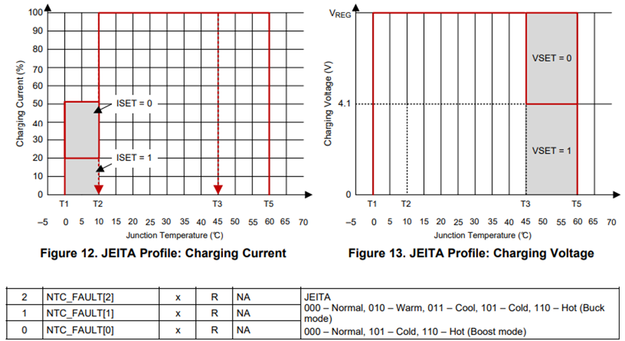

I want to ask the transition time because there are no specification on the datasheet.
For example, I want to know the estimated time when the profile is changed from Normal to Warm at T3.
If the transition time is different each of T1 to T5, could you share each of transition times?
