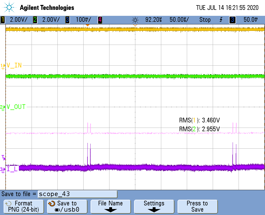

I see that at Iout less than 5 mA device doesn't regulate the output voltage.
Vin=3.8V Vout=3.2V,
Vin=4.0V Vout=3.4V and so on.
I see no pulses on SW pin. I see pulses on SW pin and regulated Vout if input voltage between 3.3 and 3.6V.
If Iout greater than 5mA device works properly.
On screenshots Yellow - Vin, Green - SW
Vin = 3.6V
Vin = 4.0V

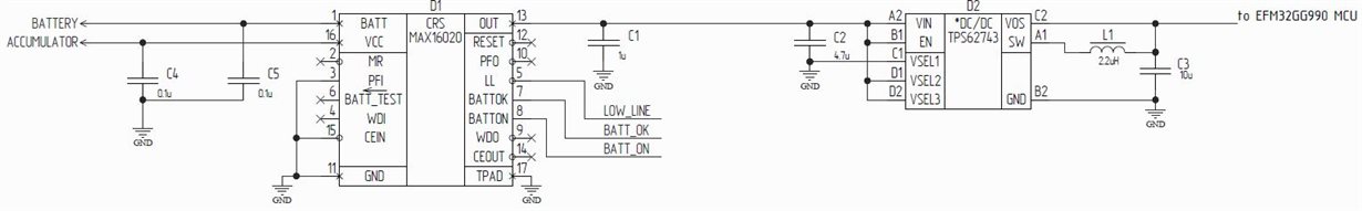

  • Hi Vasily,
    Could you please share the schematic?
    Febin
  • Hi Febin
    Simplified schematic
  • Hi Vasily,
    The schematic looks fine. It could be a probable mistake in the measurement.

  • Febin, thanks for reply.
    There's no mistake in measurements. I measure Vout by DC voltmeter and i have the same result.
    Vin=3.8V Vout=3.2V,
    Vin=4.0V Vout=3.4V

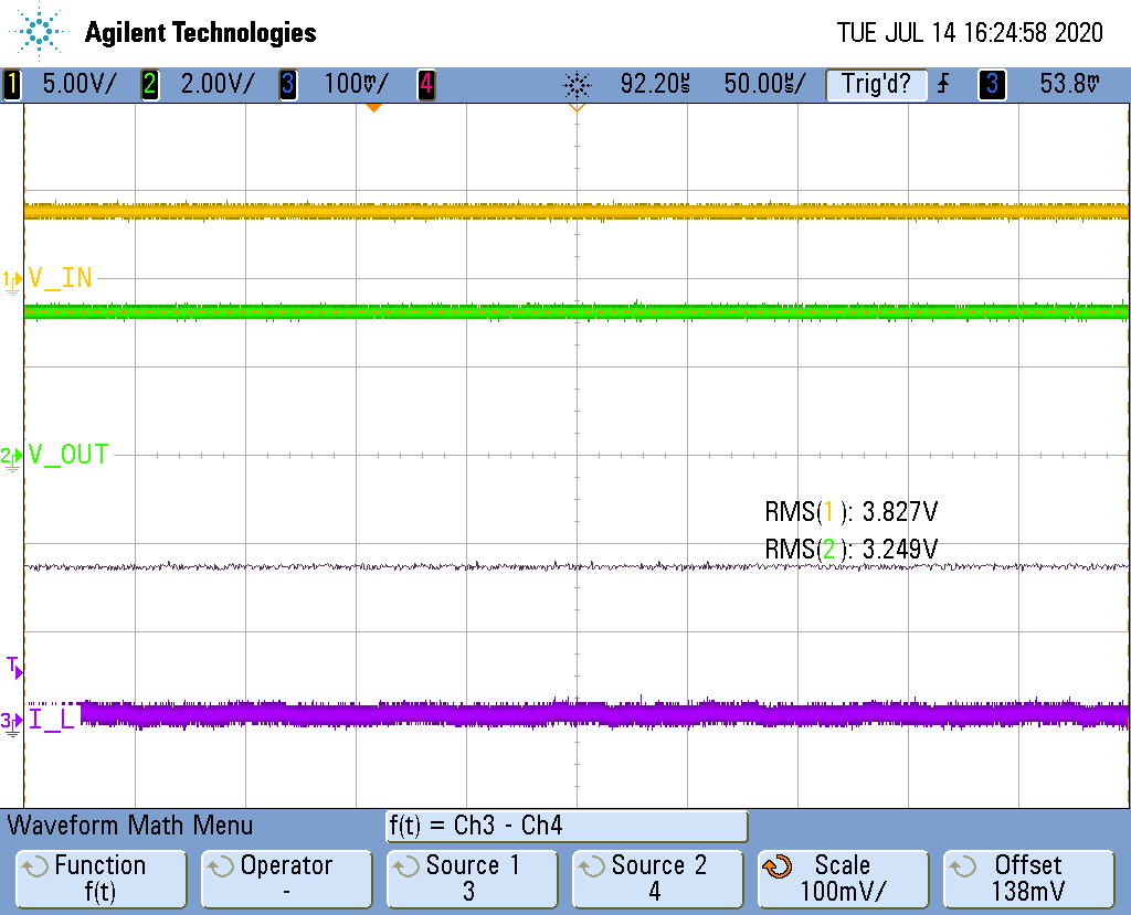

  • Hi Vasily,
    You mentioned that you can't see the SW waveform. For this I suggested the above changes.
    Secondly, please provide on the same plot: Vin, Vout, Iout waveforms for 5mA and for a higher load separately. (Please measure across C2 and C3)
    Please ensure you use a stable input supply.
    Febin
  • Hi, Febin
    Iout measured on 1 ohm shunt resistor by subtraction scope channels 3 and 4. Shunt resistor connected between L1 and C3.
    Channel 3 is L1 output.
    1. no load
    Vin=3.5V Vout=3V
    Vin=3.8V Vout=3.2V no pulses on SW pin
    2.  load resistor 560 ohms
    Vin=3.5V Vout=3V
    Vin=4.1V Vout=3.15V no pulses on SW pin
    3. load resistor 56 ohms
    Vin=3.6V Vout=3V
    Vin=4.4V Vout=3V device works fine

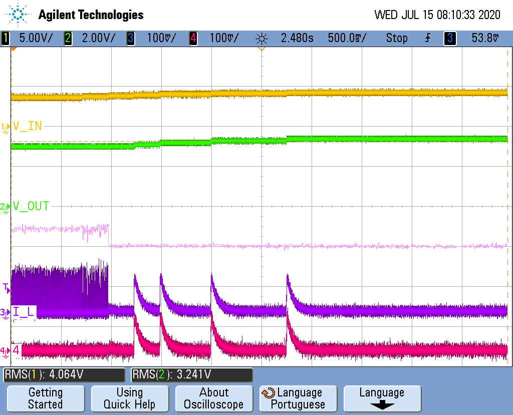

    4. Increasing Vin manually
    At Vin=3.7V device stops switching and Vout tracking Vin.

  • Hi, Febin.
    I'm sorry for the delay.
    I use MAX16020  powered directly from li-ion cell.  MAX16020L have push-pull outputs. I found leakage from LOW_LINE and BATT_OK outputs to power rail through MCUs input pins.
    I should use the open-drain outputs version of MAX16020.
    Thank you for your help.
