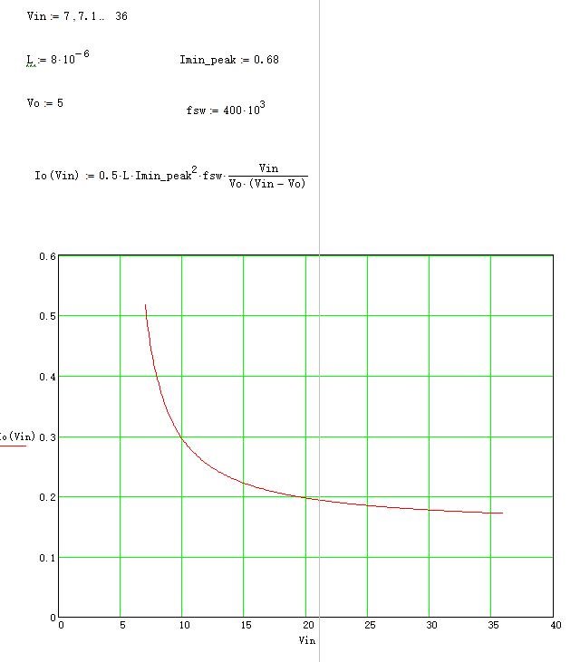

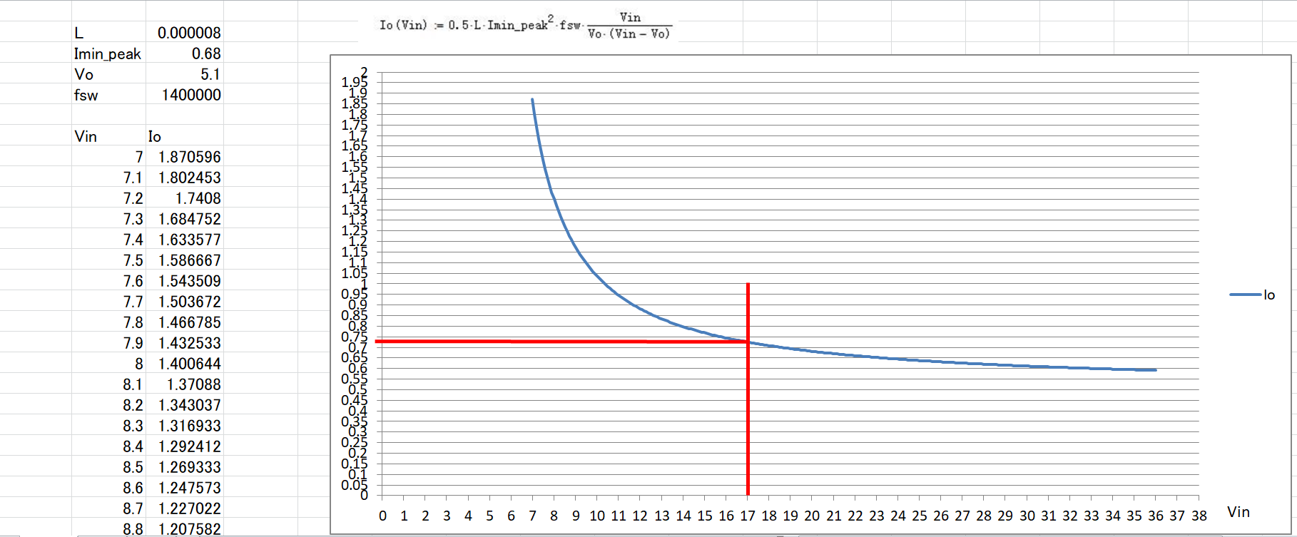

Hi

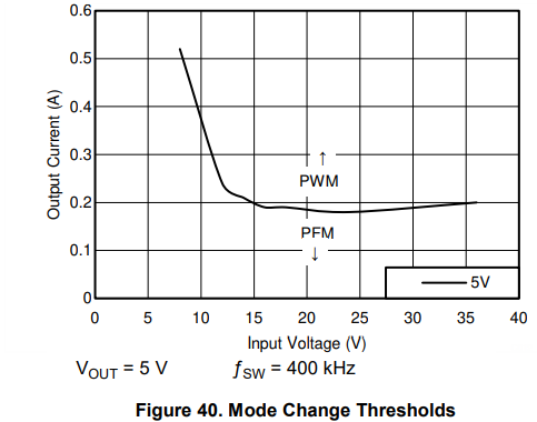

Since the graph for mode threshold in datasheet only shows when fsw=400kHz.
I would like to know the load current, which means the point that change between PWM mode and PFM mode for the condition below.
Vin : 17V(typ) (16V~18V)
Vout : 5.1V(typ)
fsw : 1400kHz(typ) (LMR33630BDDAR)
From the graph below(fsw=400kHz), for Vin=17V, Vout=5V, the point change between PWM and PFM mode is when the load current becomes about 0.19A.
