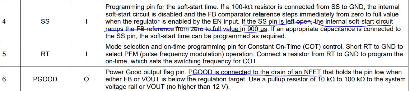

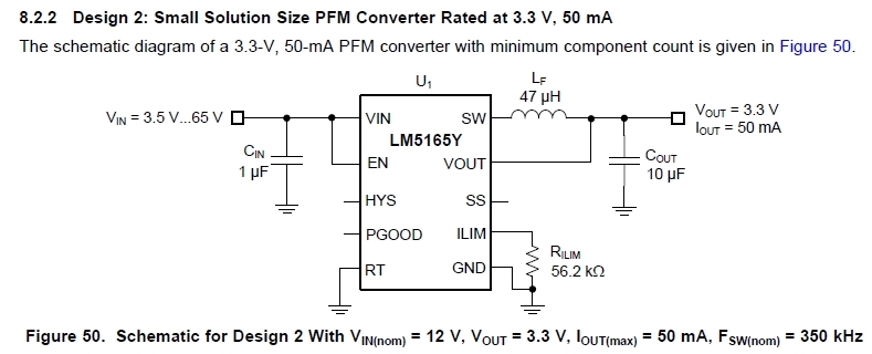

I'm using the chip LM5165YQDGSTQ1 model, and designing the PCB with a guide of the datasheet.
In LM5165 datasheet, section 8.2.2 is showing the PFM converter at 3.3V, 50mA. Then I found that PGOOD, HYS, SS pins are not connected at all.
Is it okay to just let them open?
