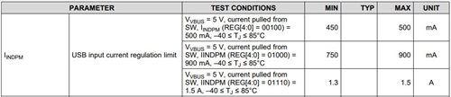

Could you tell me about the accuracy of IINDPM?
The following information is included in the data sheet.
I tried to calculate the accuracy from this information.
However, the accuracy varies depending on the set current value.
What is the accuracy of the set value?
Or Could you tell me the accuracy or Min/MAX for the following settings?
"3.0A(IINDPM[4:0]:0b11110)"
Power supply source is the AC adapter.
Customers want to use current up to the adapter rating.
Therefore, customers need IINDPM accuracy information.
