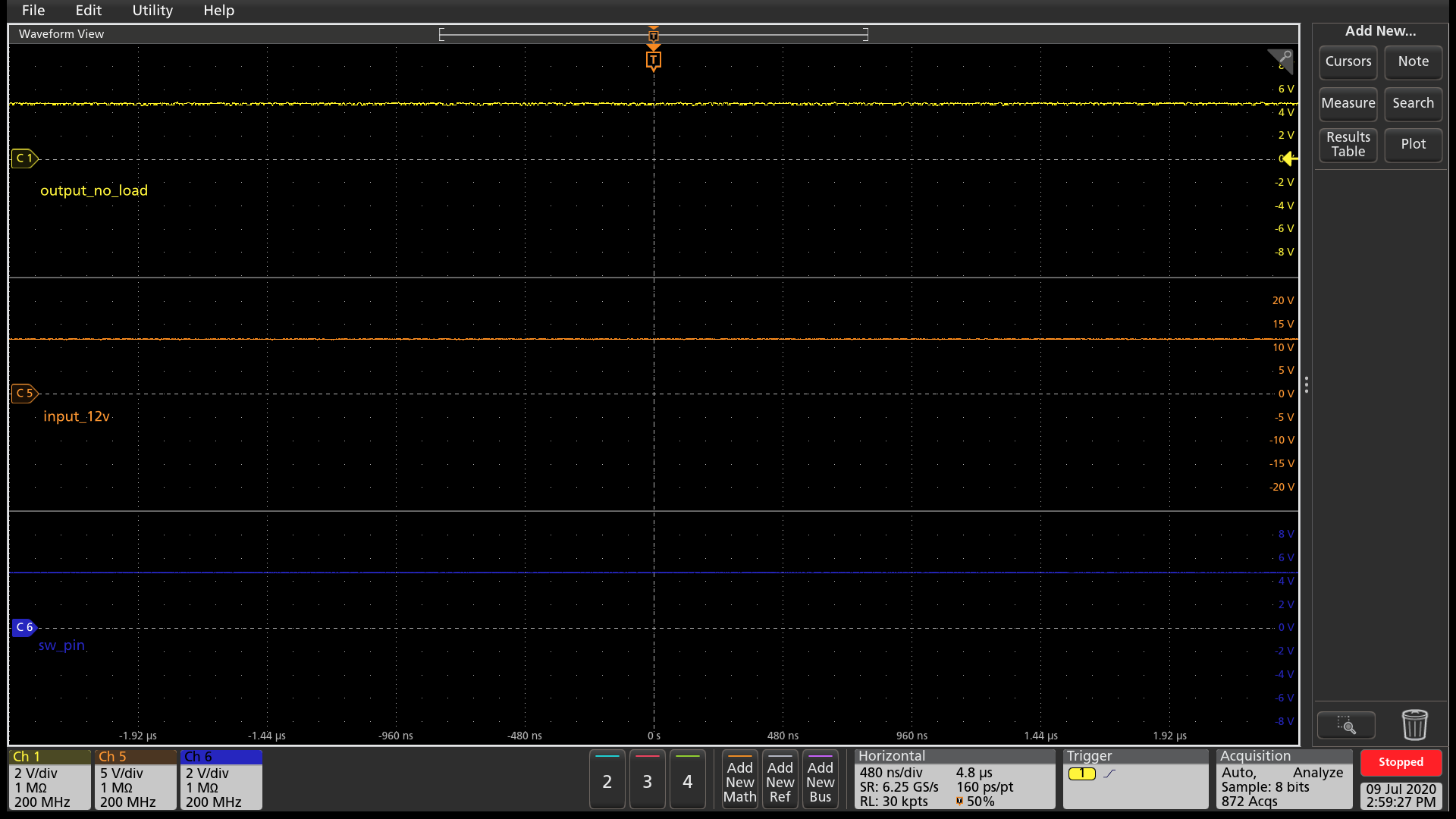

Hi there,

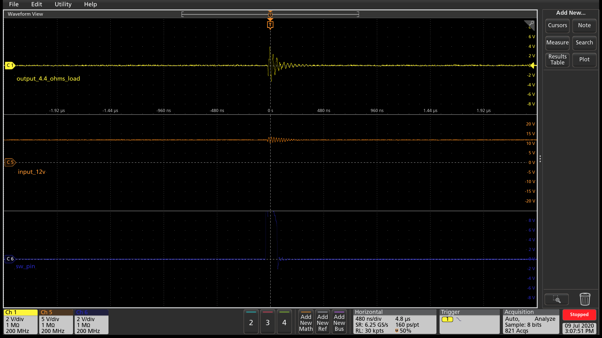

I designed a circuit with this chip using the WEBENCH Power Designer to receive 11V-13V from input and deliver 5V at ouput (2A).
Then I made a PCB using PADS but it only works without load.
Everytime I connect a load at the output the circuit turns off.
I noticed that the load needs to be disconnected and Vdd reseted to get 5V at output again with no load...
Can anyone tell me how to solve please?
