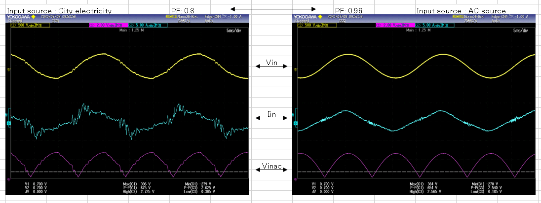

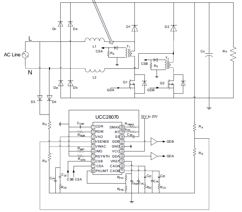

UCC28070 Implement Bridgeless PFC Pre-Regulator in the circuit.
Cpmparing with AC source, the PF decrease obviously when the input is city electricity.
Can you figure out the reason about this issue?
And how can we optimize the shcematic?
