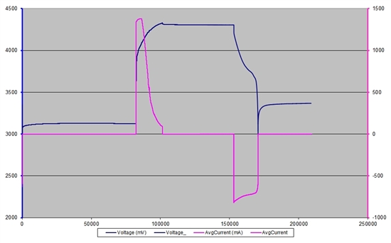

  • Dear Charles,
    I'm experiencing problems with learning cycle too :-(
    My battery is a 3700mAh Li-Po cell, so learning cycle are quite long ...I only want to configure the bq27501 for this cell.
    I have fixed some errors by reading your previous message that is very explicit. Meanwhile, learning cycle always finish with this message : Dataflash.GasGauging.State.UpdateStatus 0 does NOT = 2. Impedance track learning cycle was not completed correctly for both packs. Use Pack A and repeat. I've check registers and I don't understand what is wrong... maybe chemistry ? I have process to a chemistry cycle with less than 1% error but I wonder if the bq27501 keeps this parameters when learning cyle fail?
    upload file is not working (2Mo zip file), can i send it to you by email, this zip contains log and dataflash export.
  • Hi Julien,
    If you only plan to use one battery type then I would recommend that you use bq27500 (or better yet, bq27510) instead of bq27501.  Because bq27501 is designed to store two different battery profiles, the creation of a golden image with bqEASY is trickier and requires that you repeat two learning cycles (one for each profile) and correctly switch profiles for each one by using the resistor ID (RID), which is also tricky to configure.
    Also, what is your current during the learning cycle?  It must be at least C/10 (3700/10 = 370mA) for a succesful learning cycle.  However, your problem is probably not related to that but rather to the challenge of running two learning cycles to get the two Update Status registers equal to 02.

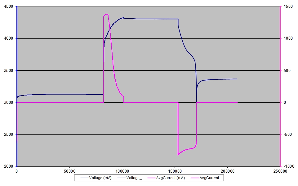

    I have try to "fake" the second cell by configuring the second RID with an other resistance value. I've made the second cycle with this resistance instead of the RID cell.
    I think it was working because QMax cells values were both modified.
    Here is a graph (for the second cycle) :
    Discharge current is about 700mA.
    Unfortunately our target PCB is already in production :-(  But I will try to change the chip on a PCB to check if it is not working better with a bq27500.
