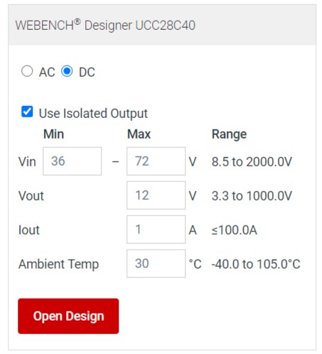

I have designed DCDC converter using UCC28C44 & UCC28C40 IC. I took help of WEBENCH. Here the transformer details, like Lp, turns ratio etc are given but core size (type, make, part no) is not given, can you pls help me with this.
transformer parameters as well as surge suppressor components are dependant on transformer core size. hence its important to know the core size considered while designing in WEBENCH.
specification: input 18V to 80VDC & output 24V, 5A, 120W
