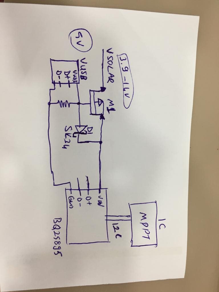

Hi all,
I want to use BQ25895 with both solar and usb input.
I'm going to mppt with an IC for Solar. But as soon as I plug in the USB, I want this mppt to be disabled and charge it from normal usb.
To do this, when I plug in the USB, I detect the D+, D-pins and set it to AUTO_DPDM_EN 1. Can I disable the mppt and charge with usb?
because I saw an example like this:    I2c.write(BQ25895, 0x02, B11111111)
I share a simple scheme.
Can you help with this?
