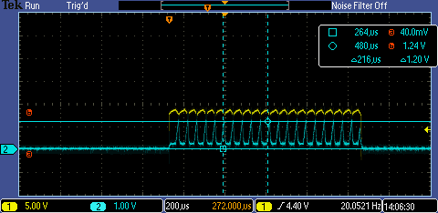

I have the following circuit, to pulse a string of 3 leds at 2 A and around 8 Volts , strobing the signal at 1 mS aprox

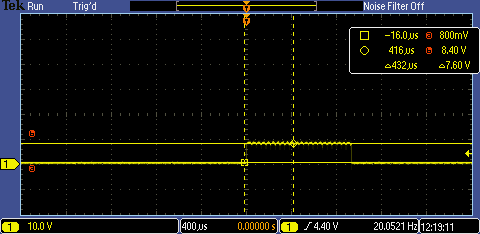

The circuit works basically fine, with this output after L12, taking the snapshop of the oscilloscope

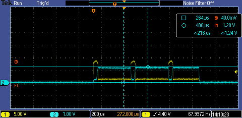

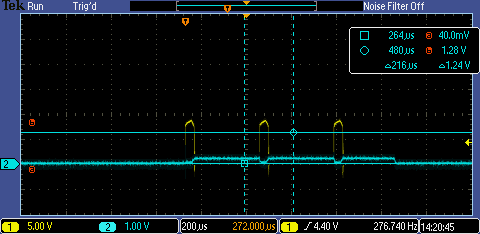

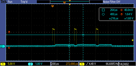

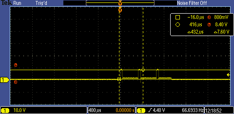

Now, the coil model has been discontinued, and when I try other models of 47 uH, then what I have is this:
I dont know what can be the difference, as all coils that I try have 47 uH. The only difference is the internal resistance, which is different from one model to another (and I guess other internal parameters as well). I have tried with models of coil with similar internal resistance (not easy to find exactly the same) but with no luck.
So I am a litle bit confused.  Someone can help ? I dont know what it is happen
