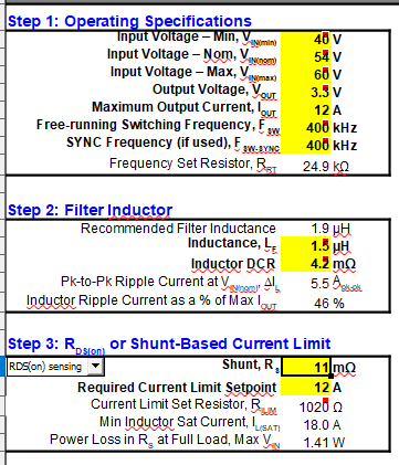

  • Hi Arief,
    Thanks for the immediate response.
    When we entering the values through the calculator Rlim value is  ~ 1K.
    Below is the manual calculation, Based on the datasheet formula. Please let me know which one is correct, we will be operating the device up to 55°C.
    RLim  =   (Iout - ΔIL/2)*Rdson(Low side mosfet)/Irdson
               = (12-4.8/2)*11.7mOhm/200*10^-6
    RLim = 561.6 Ohm
     T = R*C = 1k*15pF = 15nS(which is comparatively higher the datasheet spec)(Calaculator)
    Please advise which is the best one to follow, so that the device would operate at its peak without any malfunction.
    Ashwin S

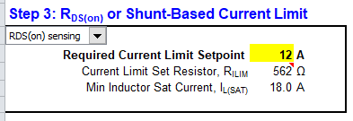

  • HI Ashwin,
    I think the discrepancy is what method of current sensing that you are planning to use.
    Are you using the Rdson sensing or are you using Rsense sensing? The Rsense sensing requires an extra sense resistor at the bottom of Low Side MOSFET.
    If you use the Rsense method then the denominator should be 100uA instead of 200uA.
    Do you enable macros on the excel? Maybe when you choose the drop down box, the forms did not get updated.
    You can see on the bottom, if i use the RDS on sensing the value of resistor is 562 ohm. This is because the peak to peak ripple current is calculated at the nominal VIN of 54V and the delta IL is 5.5A instead of 4.8A
    -Arief
  • Hi Areif,
    I arrived at the same value during the manual calculation for Rdson sensing mode. I am using the RdsON sensing mode.
    Yes the macros is not updated in the excel, i will be using the 562ohm as Rlim and will adjust the Clim value in order to meet the 6ns timing specification.
    Ashwin S
