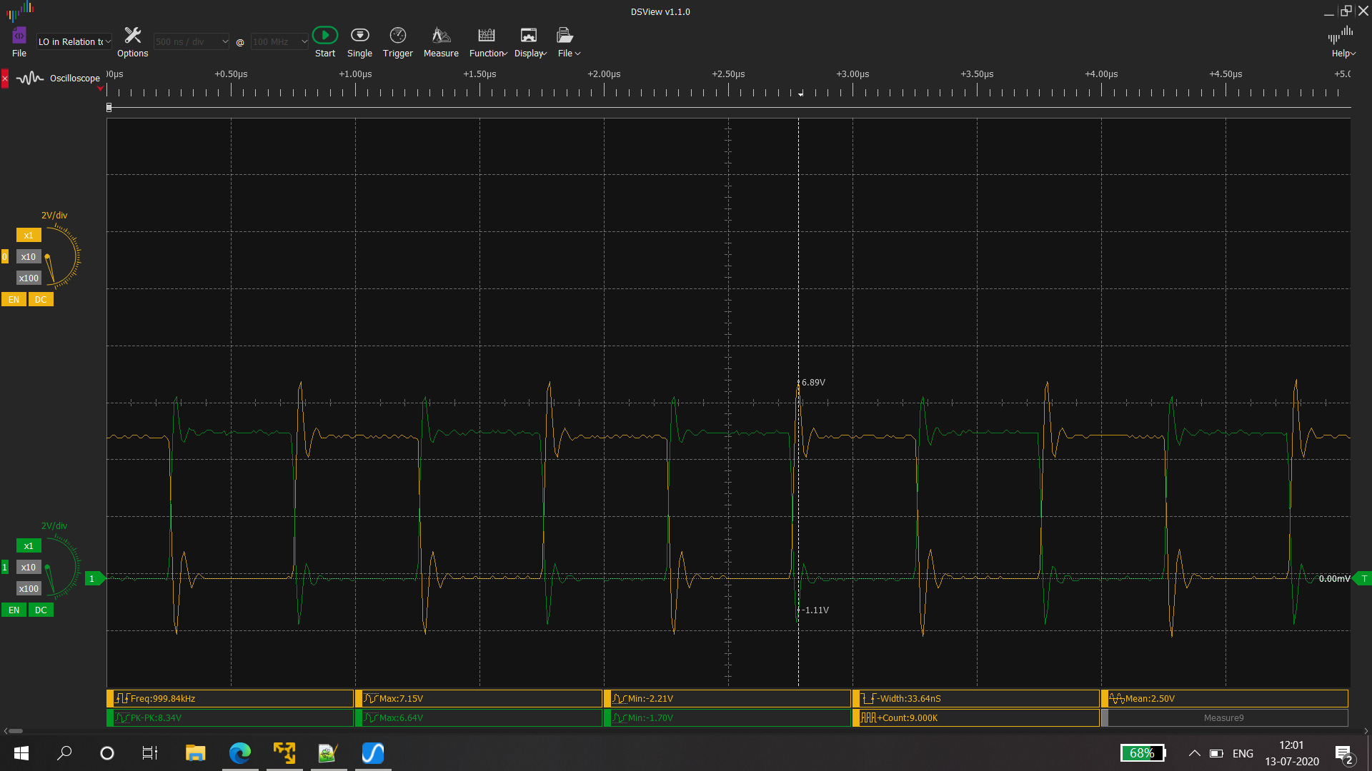

  • Hi CP,
    Thanks for reaching out on e2e for lmg1210 EVM.
    Can you take a scope shot of HO with respect to HS on the same plot as LO with respect to VSS?
    That way we can see what the outputs are doing when the high-side FET burns.
    >> Attached png this capture is when We provide Vin ( LMG1210 ) = 12V DC to LMG1210 and Genfet with +5V DC

  • Thanks CPU.

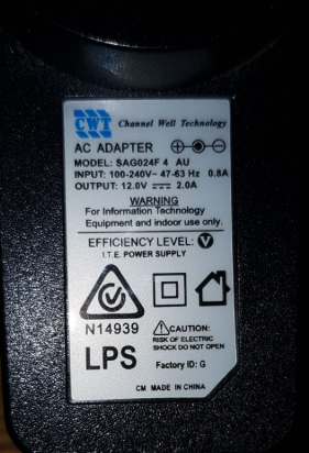

    Can you confirm that you are applying 12V  DC voltage to VIN?
    From the waveform the VIN voltage is pulsed and does not appear to be DC.
  • Hi Jeffey Mueller,
    What we have used to LMG1210 is 12V DC only.
    Please see the Adapter used details.
    C P U

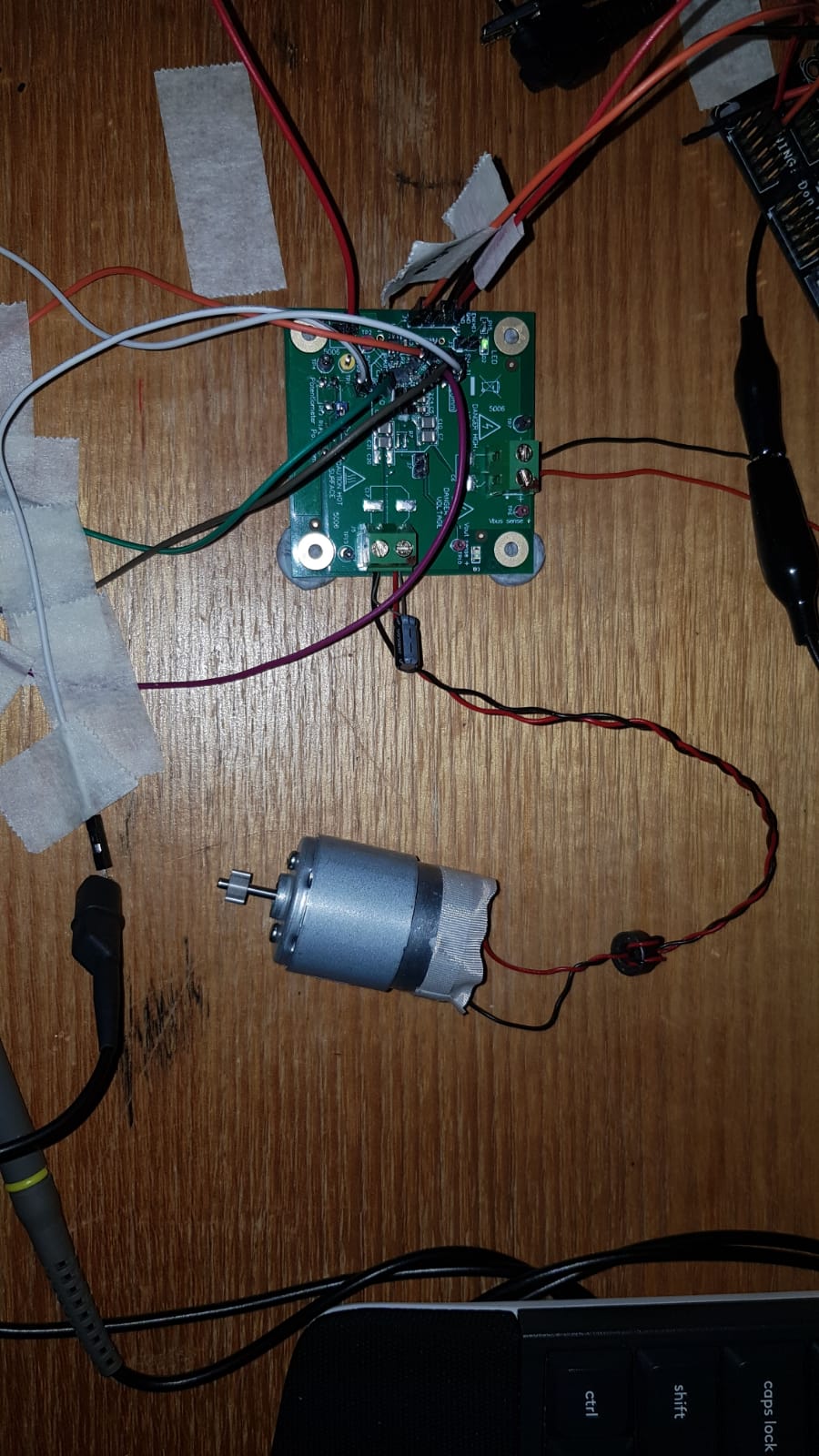

    >> We now working with Independent mode , be feeding a 200ns period with duty cycle of 15% . Please find the pdf attached on how we are feeding en_hi and pwm low pin of LMG1210 input with ground in common between FPGA board and LMG1210 board ( picture  attached ).
    Can you replace the FET and confirm that the HB-HS voltage remains at 5V during all switching cycles?
    >> Yes we observer it is varying between 5.2 to 5.75 V .
    All the Above experiment is done by Feeding J1 ( VIN LMG1210 ) with 12VDC, J3 is short , J6 open, J2 ( VDD 21VDC) and load of 330uF capacitive ( 60 V rating capacitor ).
    Finally our actual load is 3.2uF and we should have swing in voltage between 2.5V to 26V . So kindly suggest on how to proceed further in achieving the same ?
    Attached the PWM high low pdf, setup picture and HO to HS Voltage png.

  • Hi CPU,
    Thanks for the update,
    Does the high side get burn?
    Or does the issue improve or dissapeared with your current test conditions?
  • Hi Jeff,
    It is not burning but observation is temperature is shooting upto 130 degree Celsius. And difference between HO vs HS is around 5.7 v. As per datasheet if exceeds 6v it burn.
    We need an output swing vary between 27 v down to 2.5 v. As per present circuit we will not reach above 21v is it right ?
    C P U
  • Hi CPU,
    Seems to me this issue is thermal related. So if measures are taken to not create too much thermals on the evm it should not burn.
    Let me know if you have any other questions on this issue.
