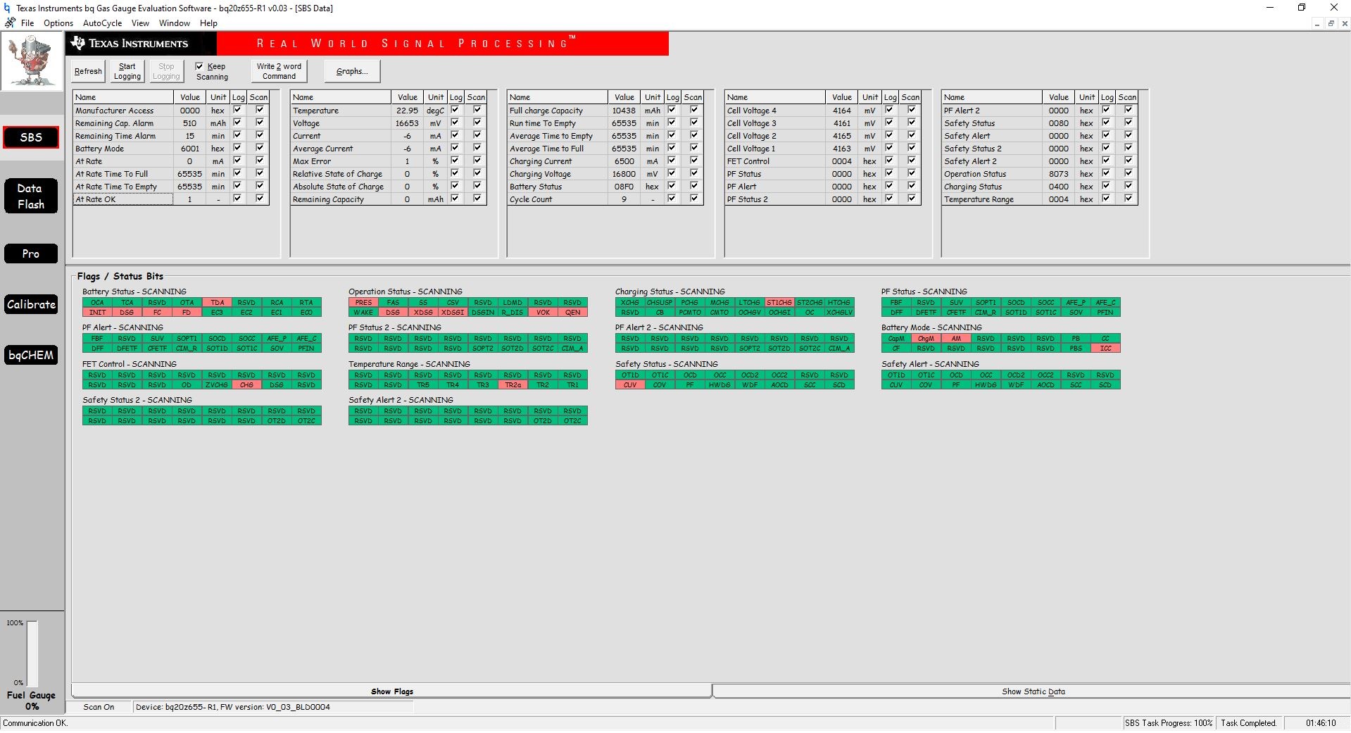

  1. First I have charged my battery to full. It turned off CHG mosfet after charge termination.
  2. Then I put my battery into climate chamber.
  3. Decreased the temperature to -30°C.
  4. Waited 3 hours.
  5. Start to discharge.
  6. Cells voltages dropped too fast
  7. Then CUV flag set
  8. Discharging has been stopped.
  9. Increased temperature to room temperature.
  10. Waited 3 hours.
  11. My battery doesnt charge.
  12. I have checked SBS screen and saw this sitution.
My battery allow charge after I sent 41 command. But my costumer would not be able to send 41 command to battery. Isn't it a bug of BQ20Z655-R1?
