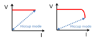

(2)Next I would like voltage-current characteristics at hiccup mode. I think its shape is like two attached graphs. Could you show me if LM61460-Q1’s voltage-current characteristics are like left figure or right figure?
In addition, I would like the voltage-current characteristics graph if possible. If not possible, please tell me its rough shape with some values (V, I).

    The device will continue to supply current during current limit. The inductor current will bounce between the peak and valley current limit (IL-HS and IL-LS). It will not immediately go to zero during overcurrent.
    The output voltage at current limit would be VOUT(ILIM) = ILIM_avg * RLOAD. Depending on Rload the output voltage could go to 0V but not necessarily. The ILIM_avg would be between IL-HS and IL-LS. The voltage-current characteristics really depend on the Rload but your second graph makes more sense.
    If the other hiccup mode conditions are met, once there are 128 switching cycles in current limit then it would go into hiccup mode and disable switching.
    See figures 22 and 23 in the datasheet.
