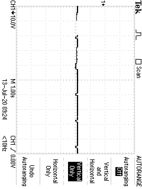

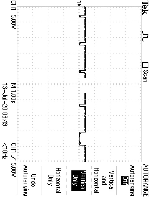

We just purchase BQ24616EVM and we having issues when charging is almost done. The stat1 starts blinking and you can see on multimeter 2.5A coming on and off. The stat2 led never comes on to show the end of charging.
Our setup:
 Battery: 4S4P Li-ion battery rated for 3.7V 2400mA each (but actual voltage is higher and this battery pack with internal BMS unit)
 Vbat set to 15.2V
VIN: 24V- 5A
