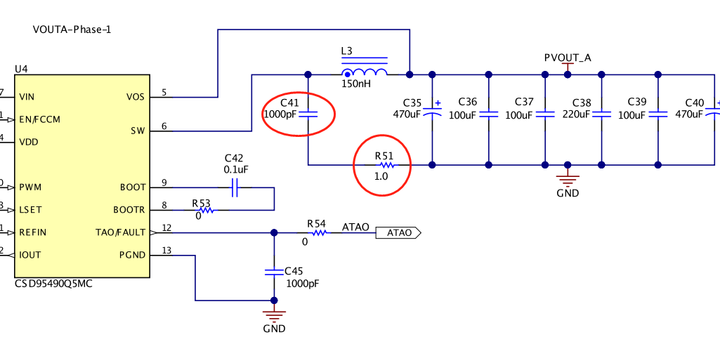

    However, when we remove the resistance and capacitance from the SW, such as C41 and R51 in the figure below, this problem will not occur.
    Excuse me, what's the reason for this?

    • Are you seeing Vout UVF alarm during system running properly.i.e. Vout=0.755V? what is the boot voltage?
    • I don't have schematic of this project. Do you remove all phases snubber circuit or only one phase(C41 and R51)?
    • please confirm C41 is 1nF or 1uF?

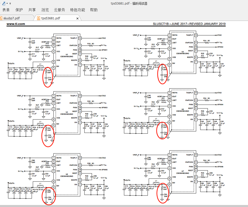

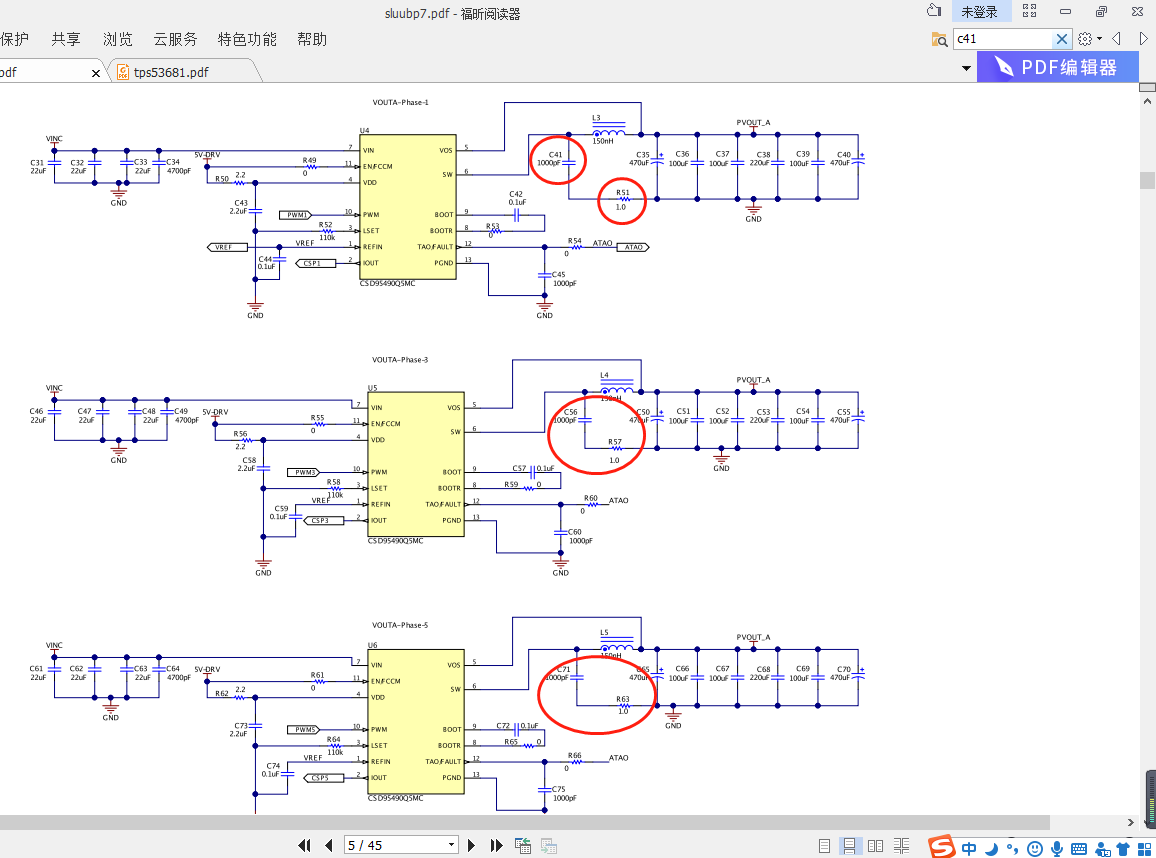

      -------See attached schematic diagram,I deleted :R204/C1666  R205/C1667, R216/C1694,R217/C1695,R229/C1722,R228/C1723   The fault disappeared
      ---------1nF

    • we don't expect any issue with 1nF/1ohm snubber values. please check is there any wrongly connected 1uF cap instead of 1nF?

                ------------ I'm sure it's 1nF/0402 ,1ohm /0402 .  Does this resistor require power??   We use a 1 / 16 w 0402 package resistor

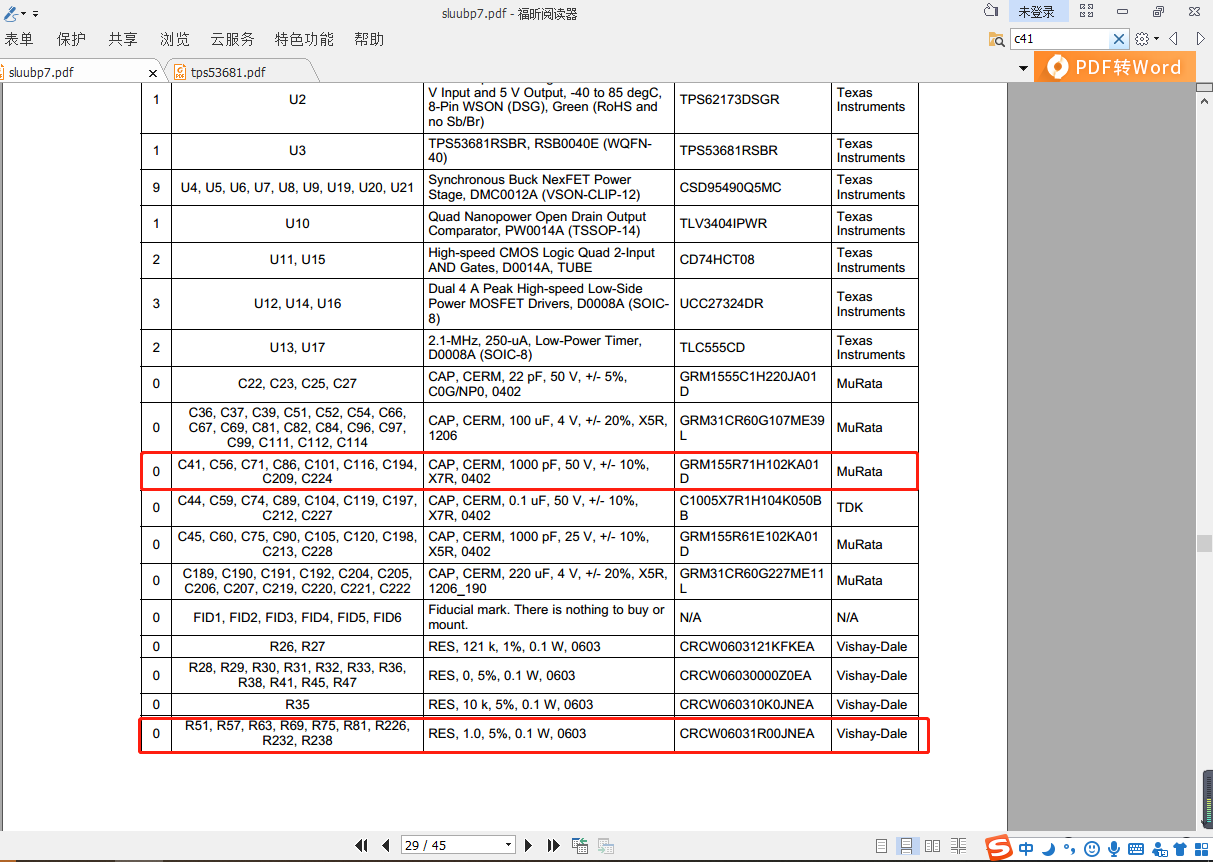

    and ,Why is snuber RC not installed on datasheet and reference designs???as page 5 and page29 of ‘sluubp7’   page 107 of datasheet

    We will optimize power stage layout on TI web EVM. SW node ringing is less, so RC snubber is not required and it is DNP.
    We have tested EVMs with snubber connections also, don't see any issues like UVF..etc. This will reduce only SW node ringing.
    Typically suggested resistor package is 0603, but if we use 0402 size also, doesn't expected any fault/shutdown system.

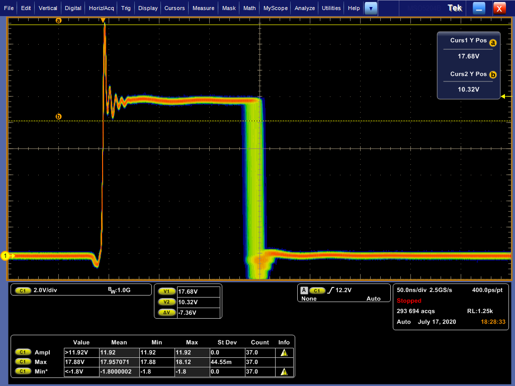

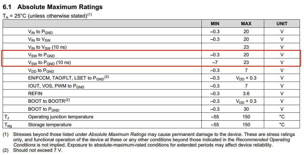

    We have removed the RC circuit. The equipment is working normally now, but the SW ringing amplitude will exceed the chip requirement (max 20V).
    If this parameter exceeds the chip requirement (max 20V), what fault will happen?

    • if SW node ringing is greater than 20V, we don't see any fault in system. At what load current are you seeing SW node ringing>20V?

               -------When the RC circuit is removed,At 120A load current , SW node ringing about 21V,In case of higher current, we have no condition to test

    SW node waveform
    • SW node waveform at 120A load with differential probe(use GND point near to SW node)

         UVF fault shutdown, unable to test phase waveform.
    SW node waveform
    We found that the Vos pin is indeed coupled with the waveform of SW. If the RC circuit is removed, the coupling will be much smaller, so we suspect that the fault is caused here
