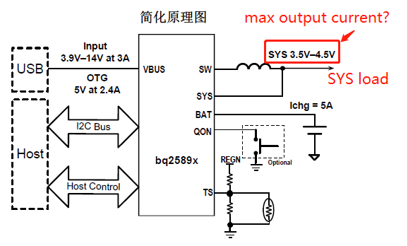

Can you provide the maximum output current of bq25892(output voltage is 3.8V)?

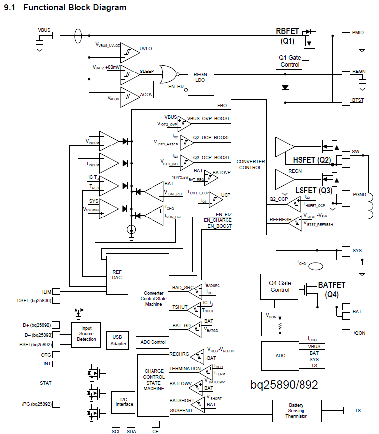

And the rated current of MOS transistor Q1 、Q2、Q3 and Q4?
Since the peak current of my system startup is 11A(voltage is 3.8V), I am not sure whether the output current of bq25892 can meet the requirement
    BQ25892 is a 5-A charger. It can handle up to 5A total current, i.e. the sum of the charging current and the system current. If there's no battery, the maximum system current can be 5A. Please note that the max input current limit is 3.25A, the system current and/or may also be limited by the input power.
    If there's no SYS load, the maximum charge current can be 5A if the input power allows.
    Ning.
  • Hi
        If the design is VBUS and battery power supply at the same time(see picture below), what is the maximum output current of the system?
    Both the charging current (IBAT) and the system current (ISYS) are considered the output current of the charger. If there's no battery (i.e.no battery charging current), the maximum system current (ISYS, i.e. the SYS load you highlighted in red) can be 5A. Please note that the max input current limit is 3.25A, the system current and/or may also be limited by the input power.
