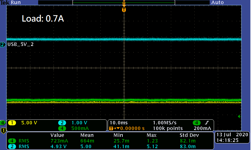

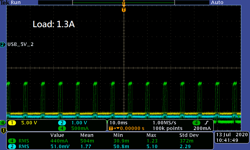

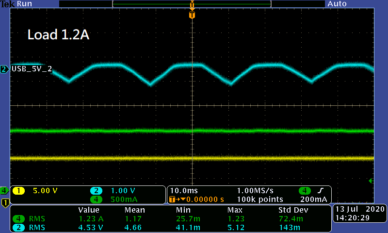

In my design, when load 1.3A, the output will drop, and load 0.6A, the output will drop to 4.94V below 5V, it is right?

It's normal to drop as increase the load due to the voltage drop at Rds(on).
But it seems abnormal for figure3. Why the output voltage has so high and low frequency oscillating value?
